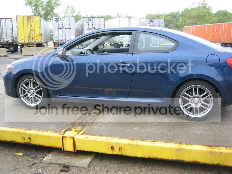

Including a laptop bag with laptop and a bunch of equipment.. plus random other items in the car.

truck weighting station... i wanted to do that on my last road trip... but i was running late =\

I was down at one of the shipping facilities for our company setting up a bunch of wireless warehouse equipment for a week. So I used one of the scales to see just how much it weighed. It is pretty handy to have a truck scale lying around to use

I'm going to be working on that side of town (savage, MN) again here soon.. so I may try to check out the F/R ratio next time I play with the scale too
