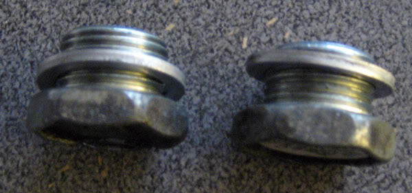

there are washers on the drain and fill plugs. Don't not over tighten them. One member was leaking tranny fluid after over tighten the drain plug. sorry i don't know the size.
