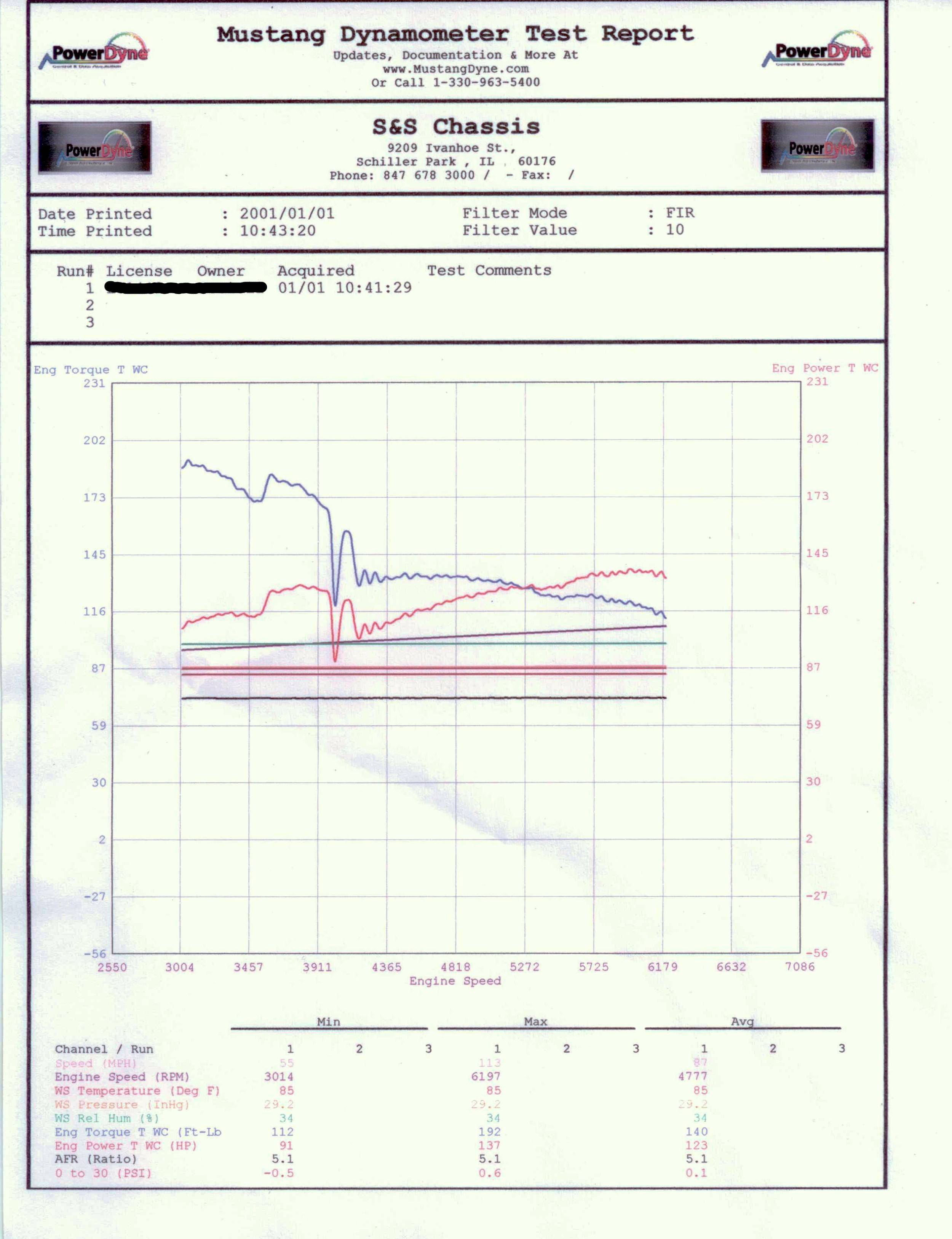

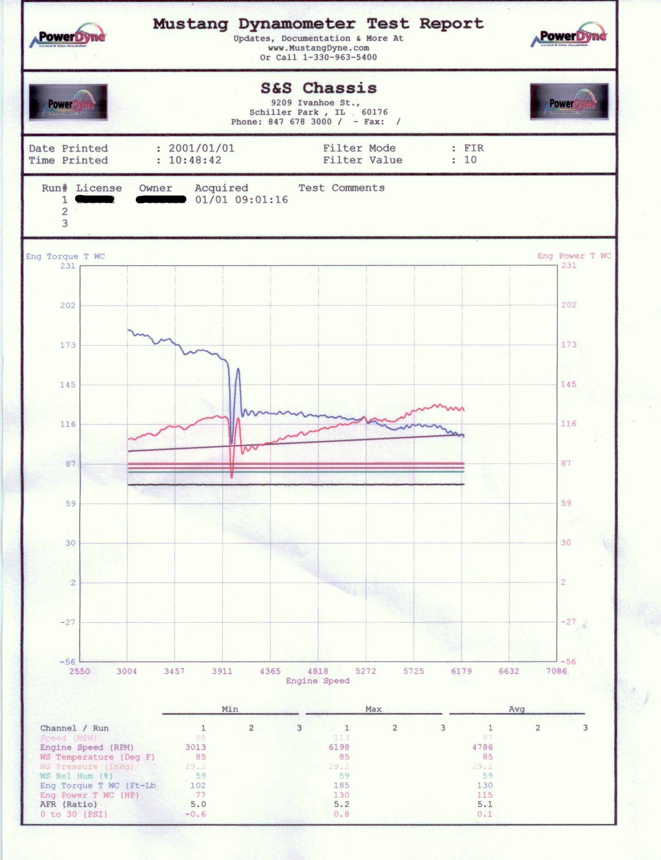

Anyway, today we went to the dyno shop to see what type of performance gains this has given us. Of course, it's nothing crazy, but around the standard of what we expected, around 6-7hp at the wheels, and about 7ft/lbs of tourque over the stock intake system with my 09 RS5 (auto).
Stock Intake:
R2C Performance Intake:
We did a few runs and the results stayed pretty consistent once the ECU adjusted to the new intake. Anyway, I am not affiliated with these guys, they just contacted me through SL seeing if I was interested in helping them test it out with the use of my car, and it involved a new intake and a free dyno, so why not?

is that sayn 132whp and 192tq!! that tq seem stupid high! with my auto 09 xb with I/H/E i had 148whp and somthing like 158tq. 192tw seems a bit high IMO

It's way high.
I was going to get that intake until the flood ruined my '07 and I replaced with an '06'...
Beware of somebody who says Injen is inferior. Read any intake comparison.
Why was there a huge drop at 4000rpm & why did they only start recording after 3000rpm? You don't know what peak (erroneous) torque is.

i still think there no way the tq is that high. thas more than alot of super charged TCs
That air box is not very well sealed on the bottom. I hope your production piece is better.
I suggested to Ed after reading the temp on the outside of my cat on a 90+ degree day at 520degrees, that he should consider putting the filter outside the engine bay, that the dyno is not going to show that.
it's an auto, we couldn't get it to stay in 3rd gear, so that 4000 is actually peaking 6200 there, computer is taking it all as 1 gear from what I could understand. Anyway, the torque does seem a bit on the high side, but I'm not sure why it is that way, I am no dyno guru. Also, are you the guy they originally used to fit the prototype?

The tq is more then a "little high" fyi.

Yea, I wonder if they set up the dyno wrong for the car.
