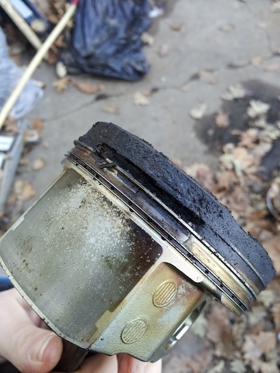

Took the engine apart and feel justified in having replaced the whole thing.
All four pistons broke, this (the 2nd, I think) the worst where an entire chunk got blown out the back end. All four similarly broke: between the bottom two rings (which are still in good condition).
This explained the horrid compression, oil consumption, and after removing the turbo, the smoke. (Yes, drove with these pistons for close to 2k miles)
Engine has since been replaced, and will be parting out the rest of this engine (everything else still looks good).
Consensus was: too much boost (when being tuned)
