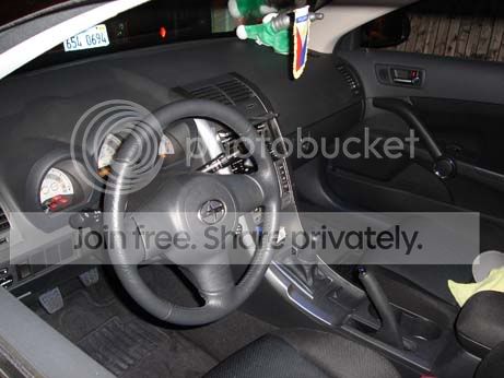

Here's a pic of the CC shifter installed:
The TWM Stage 2 is probably about another 1" lower - depending on the ****.

TWM Stage 2 installed. It looks to be the same as the CC?
