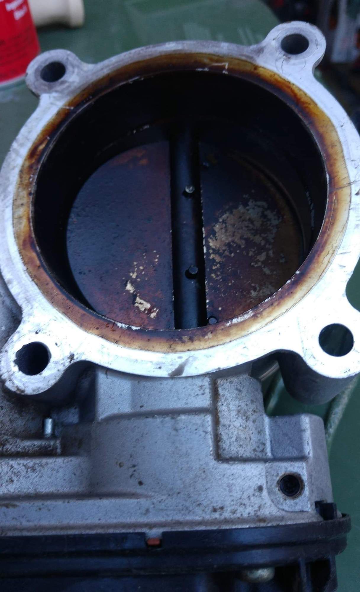

Here's a personal example of a dirty one lol. Picked up a 2014 F150 Ecoboost with 100K miles on it and here's what it greeted me with. Came from freezing cold Canada and idled alot.

Wow Brian, you did amazing job on that TB. Good work!
