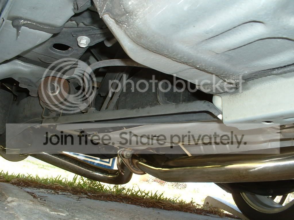

Hey Scootermafia it seems as though my pipe under the axle hangs a lot lower than yours. Do you notice that yours hangs low?

Well the seller asked for pics so I sent them. I know that Ebay has a lot of junk and you have to be real careful when you order. I actually payed $240 so for that price, it should be stainless!!!

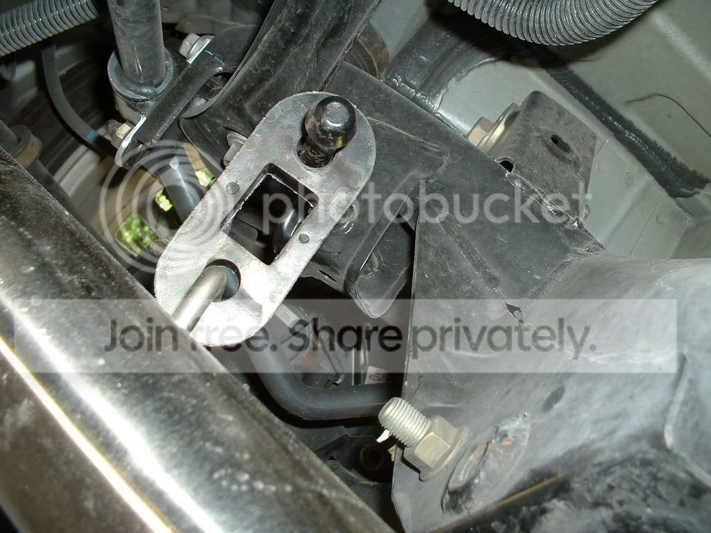

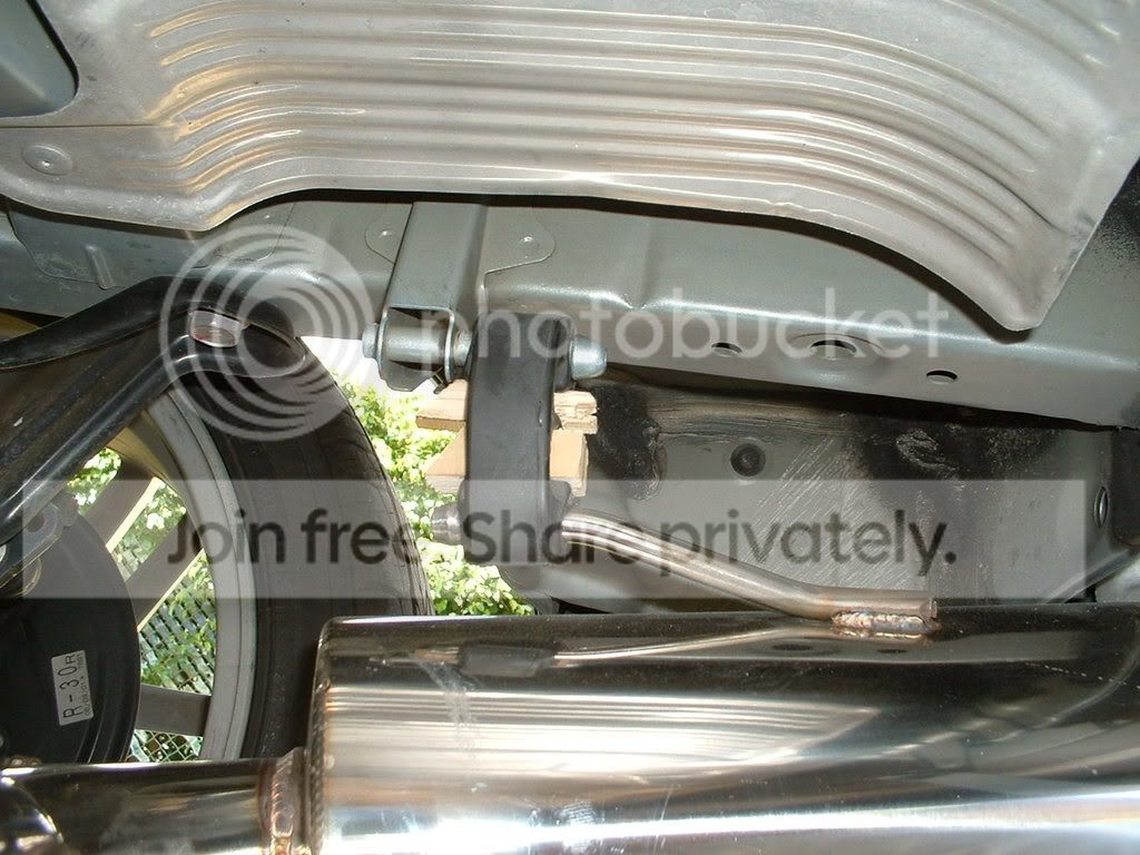

Originally Posted by Ace83
hmm wanna see pics of old tsudo catbacks and see how bad it really is. this is the closest catback i was looking for except that it has problems/issues that keeps me from getting one.
check it...
At first i was using a longer rubber hanger and had stuck pieces of wood in the other for the muffler section and look how weird the angle of the pipe that runs to the canister looks...
sorry i don't have a pic from the front...
so i took the longer hanger off and cut one of the wood pieces in half now it sits like this...
also you can see that the finish is indeed polished stainless, these pics are when i first installed it but to this day it looks just like that,and i never,never wash or touch my exhaust...to clean it that is...

Originally Posted by tc1stgen
I did get it from you guys. Here are a few pics. It figures cause I just cleaned the car and it is hard to see all the spots that I am talking about but if you look closely you can see the inperfections.
Also you can see how low the piping hangs below the axle in the first picture. I mean I have gotten pulled over for this! Now just so you know this is as clean as it gets. I have tried everything and nothing will remove these spots. It just does not shine like it should and the first pic shows a lot of the inperfections that are all over the exhaust. I really wish they could come out!
the "imperfections" look like oxidation and rust
do you live in a higly humid area?
looks yucky!

yeah tc1stgen's exhaust is unacceptable compared to mugestu's which looks normal stainless steel

No I live in Rhode Island. That too humid over here, infact not too hot period. The exhaust has only been on for six months. The seller said they were going to take care of it it just better stay that way!!! Now you guys see what I mean and why I am not happy.
