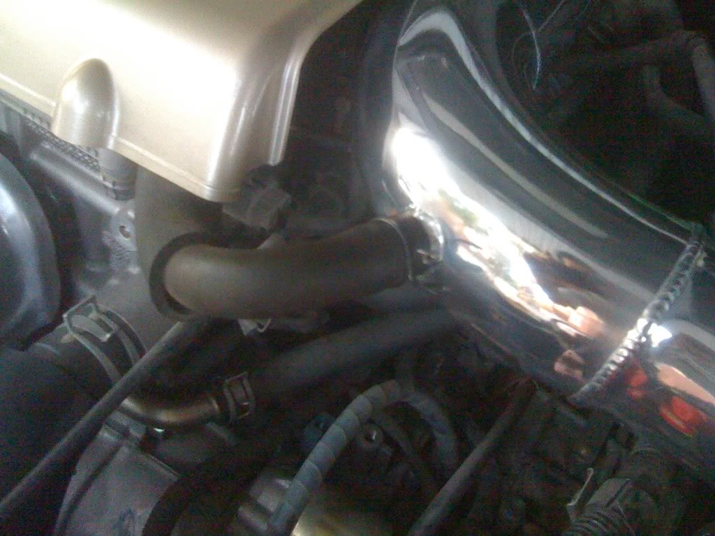

I used the stock hose to connect to the block

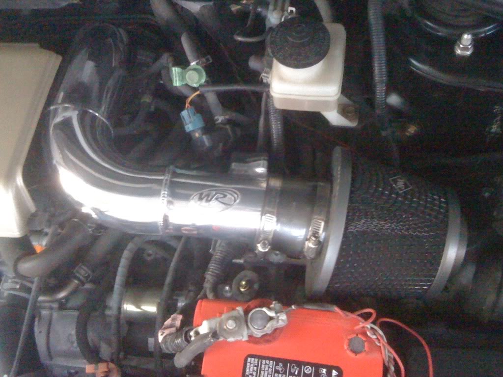

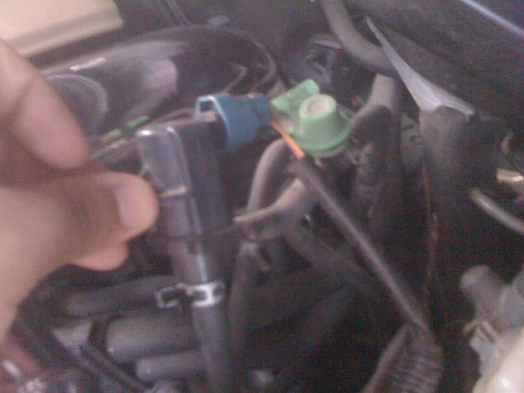

heres where i messed up i connected both hoses back to the VSV and ziptied it to the to the car

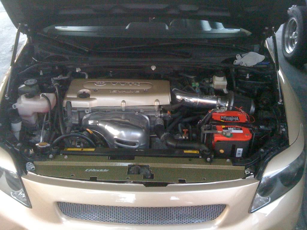

and heres my engine bay
