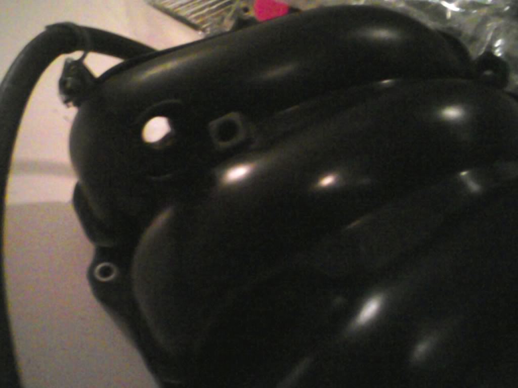

The best way is to plug the intake manifold where the PCV connected to run a hose from the PCV and the side vent to a catch can and run the catch can to the intake pipe. This prevent oil from getting in but still keeps a vaccuum on the crank pressure. Make sure to either drill out the PCV or put a different adapter on there to allow flow through it. I have tapped the spot where the PCV used to connect to with a 1/8" tap successfully and plugged it with a ss screw. Also remeber to use teflon tape so that there are no vaccuum leaks. I have a diagram I will try and post it.
