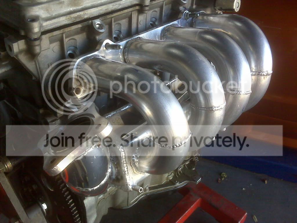

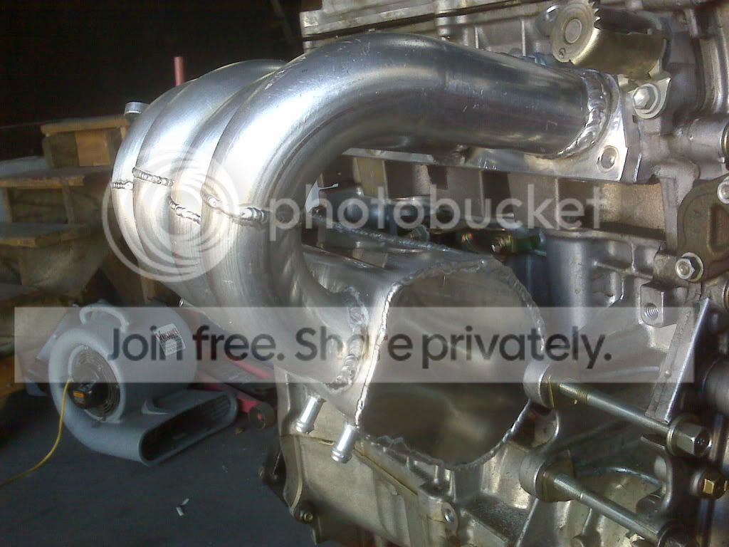

After Dyno testing and working out what could be the cause of Higher HP results but lower torque readings..
So we opted to work on it again..
THis is our final design and were dynoing it right now..
Here's what we did..
We lengthened the runners to bring the torque up...
And made the plenum slightly bigger.. with larger velocity stacks..
Please be patient for the results.. were already working very hard to make a quality product which performs like everyone wants.. Good Value for dollar is our key...

it looks mights sexy i must say

Wanted to take a POLL..
Do you guys like The fabricated bruched aluminum look or the BLING Polished look..??

i like raw aluminum or polished whatever you guys decide but since the mani is more turned now you should put the vacuum ports on top

i have to agree with this.
otherwise, the manifold looks effin sexy!!!!!!! i may not boost my car now...

the ports will be on top.. after we fnalize the test fitting.. were going to ut the ports were they can be easily axcessed..

I like the brushed aluminum look. But as long as it works and puts up decent numbers for the price I am down. It looks badbutt though thats for sure.
