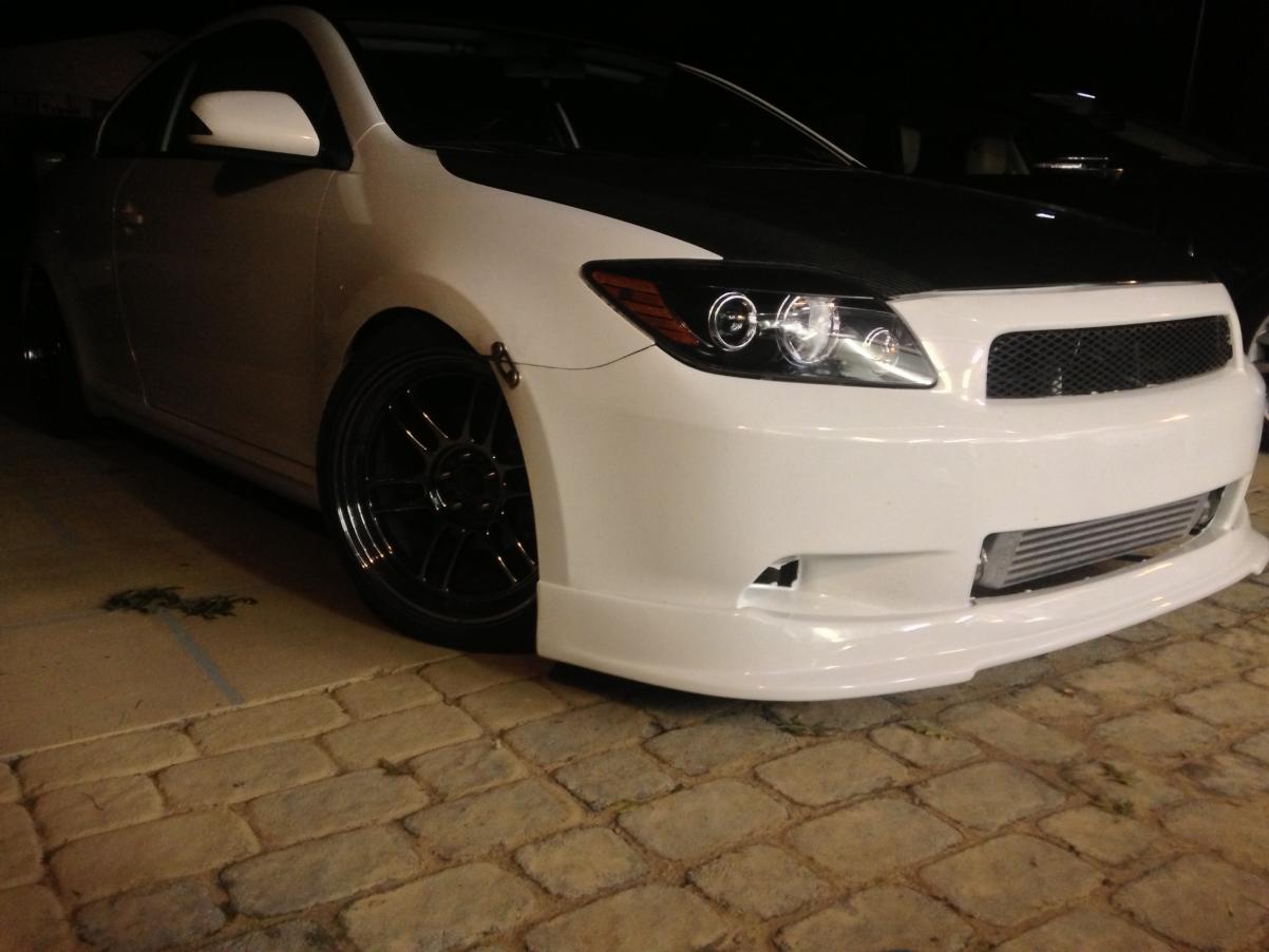

Old Jul 6, 2013 | 07:39 PM
07tctul's Avatar
Posts: 651
From: Philly
Most recent pic of the build. Car is currently at de-v in deleware getting finished up. Dave at de-v is the man, he always kept me updated and really knows his stuff. My build would not be where it is without him. Once everything is buttoned up car will be taken to jeff evans for a tune.

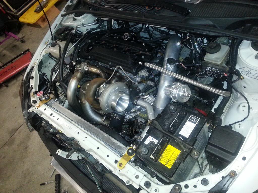

Got the car tuned at Jeff Evans over the weekend and the car made 430/390 at the wheels on 93 pump gas at 20psi. Car is having a few issues now with not hitting full boost in any gear only reaches 15psi. And car is smoking on decel. Have a few vacuum lines and piping to check to try to figure out the problems. Will post some pics soon
Old Sep 18, 2013 | 07:32 PM
07tctul's Avatar
Posts: 651
From: Philly
Pics
