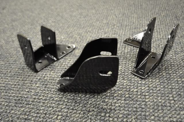

What are you talking about... ??
3 piece bolt-in mount kit is done...Products developed, tested and available now for sale. Call if you'd like to purchase or if you'd like more info.
BTW...What more did you want from us on this?

pictures of the final product installed pictures of the cage installed. what modifications need to be done to the center console to get the tc2 shifter cage to sit properly. just things like that. final product not just the brackets.

Limited pictures because because the car doesn't belong to us. If you ask I'm sure the owner would post more.

We don't have that many pictures of the car but Kareem posted some back on page 12 a month ago if you'd like to look through them.
As for the shifter assemble and cables... they bolt right in with no modification required
