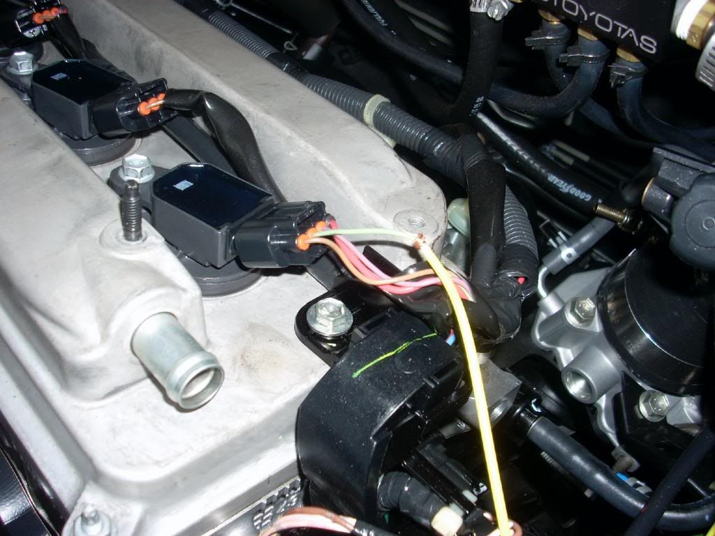

is it normal after using the 2 step that after letting off the car to stumble slightly.. also my afr's seemed lean but i think thats because i took the battery out and cleared my fuel maps!
VIDS TO COME TOMORROW!

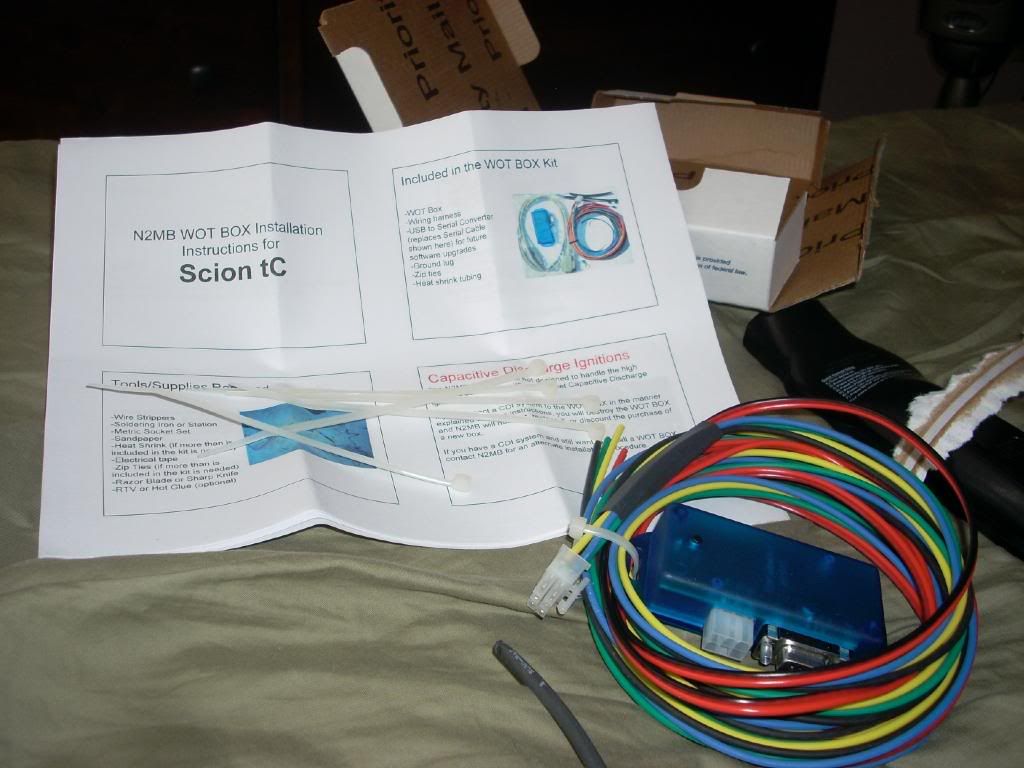

so installed the WOT Box! thing is friggin sweet. got late so no vid today.. the 2 step makes my car sound ANIMO!!
and i only did one quick no lift shift 2nd to third.. that was intense! haha

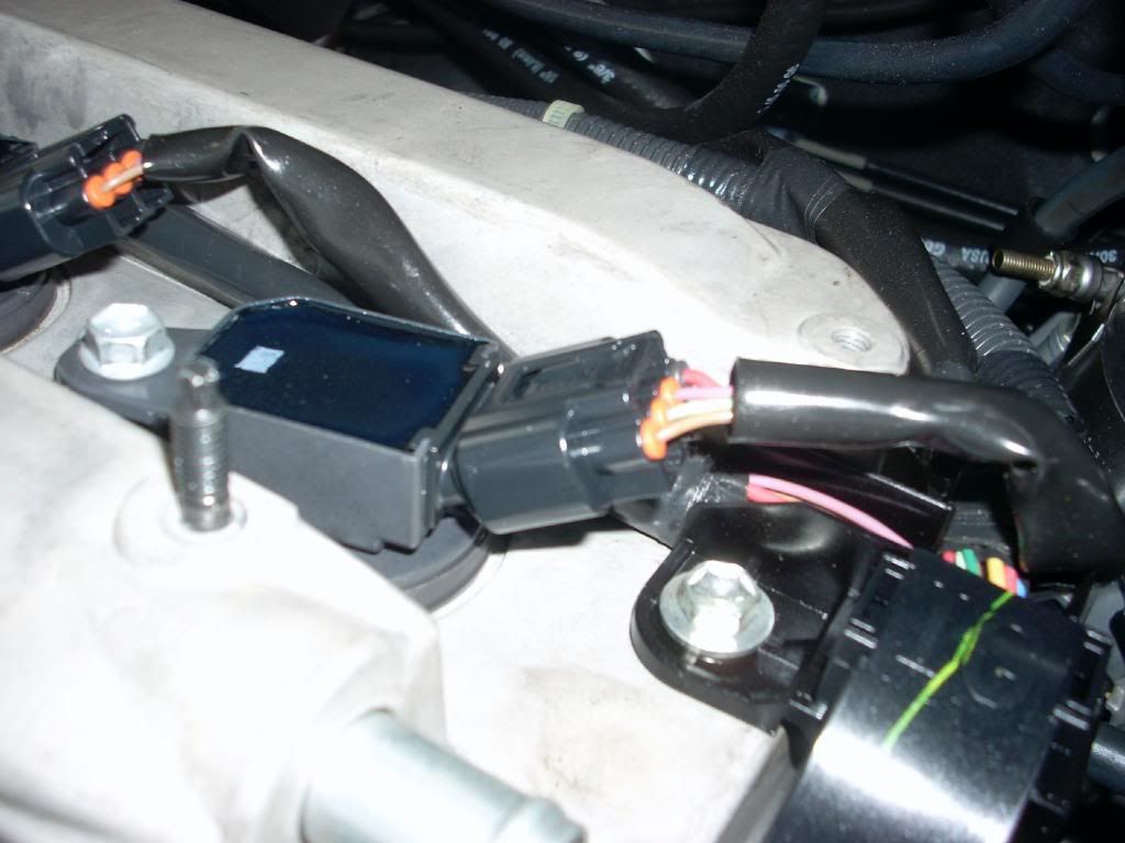

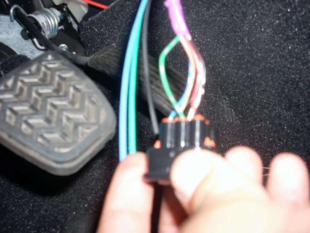

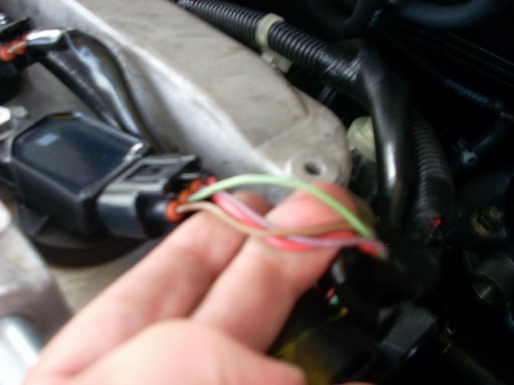

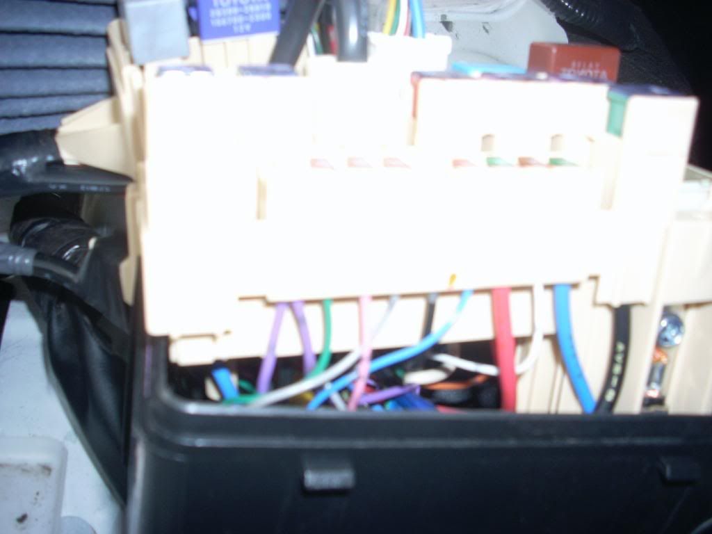

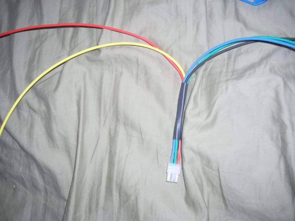

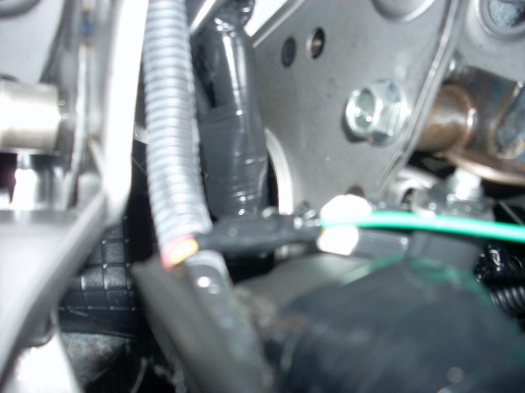

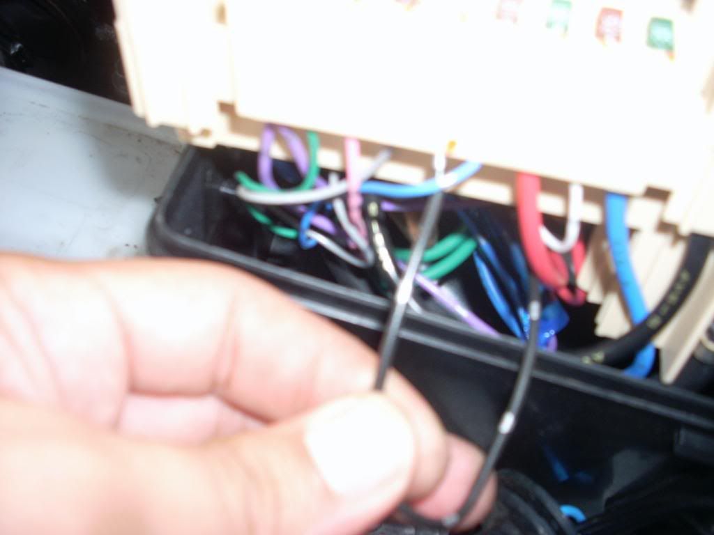

pics for olaHalo:
in this pic you can see that i seperated the red and yellow wire, the red and yellow wire are the only two that go into the engine bay:

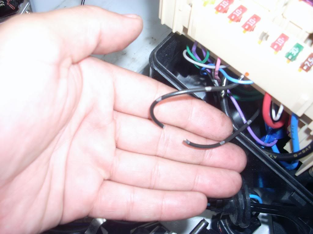

push all the clips in and pull the tan middle part out to reveal the side under the 15A (blue) fuse you will see the black wire:
cut:
i forgot to take pics but the red wire is actually two wires (you will know this when you look at it) one is a solid red wire and the other has a black strip. the red wire goes to the fuse end and the red and black wire to the other. (sorry no pic)
tap yellow wire into this light green wire:
this plug is above the gas pedal:
splice the blue into the green wire

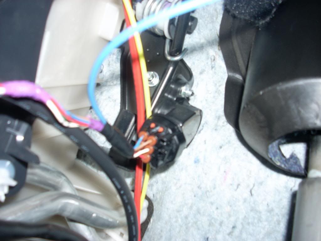

this is the absolute hardest most irritating part:
thats the plug up and above the clutch.. its a white clip with a red and yellow wire running into it. tap the red wire with the green wire:
last wire is the ground.. and i didnt take a pic cause you can use anywhere..
this wot box is worth every cent of the 190 i paid for it! and i didnt even get to fully use it yet!
