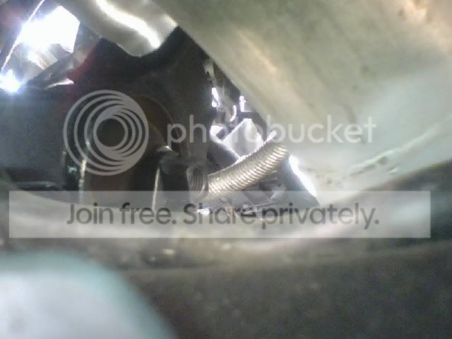

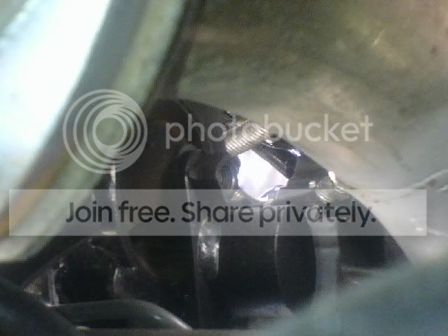

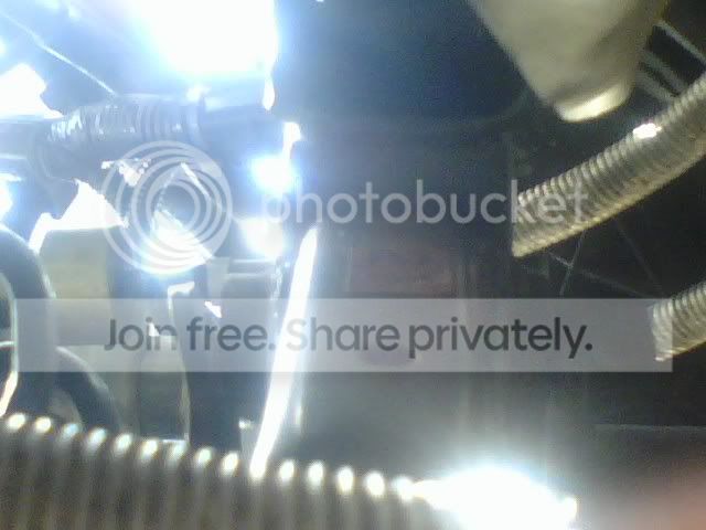

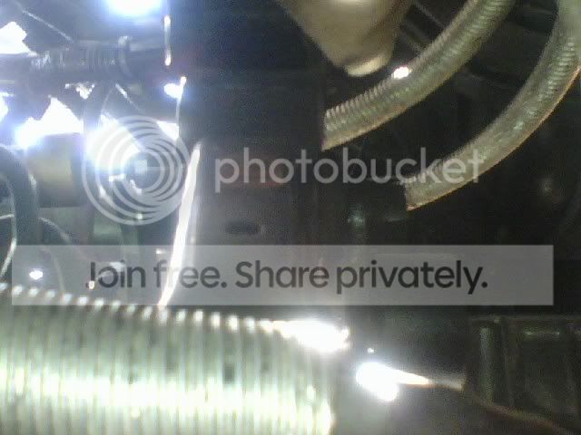

So I jacked the car up to look for anything broken. Im assuming this is my rear motor mount. As you can see from my crappy camera phone pics, there is a bolt missing and the left flange is bent
I hope this is the only thing I broke

sound exactly my rear mount when it wasnt bolted/installed right..

Does anyone think I can just get the left bracket straightened out, or do I need to buy a whole new mount?

lol its shouldnt be related unless the mount is bad in the first place.. its actually the axles that should go first before the mounts

if you think about it, if the bolt snapped it would have absorbed tension therefore not allowing hte left side of the mount to bend.
now, if the bolt came off at one point the bolt would cause a one sided tension and bend the mount
Old Oct 13, 2008 | 12:45 AM
  #154
NVMyTc's Avatar
Posts: 1,387
From: Whittier, CA
Ya that does sound like the case
And the WOT Box wouldn't cause the motor mounts to fail directly, but its more of the case of user error.
I set my 2-step too high, and even when I heard weird noises coming from the car, I decided to stay on it till the end of the run, so the broken mount is my fault
