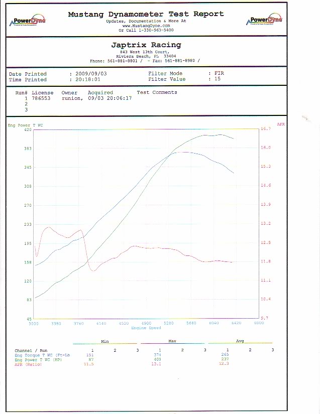

as promised here is the dyno sheet.

i noticed ur only making power from like 5800 to redline, whys the power band like that? should be making power sooner
