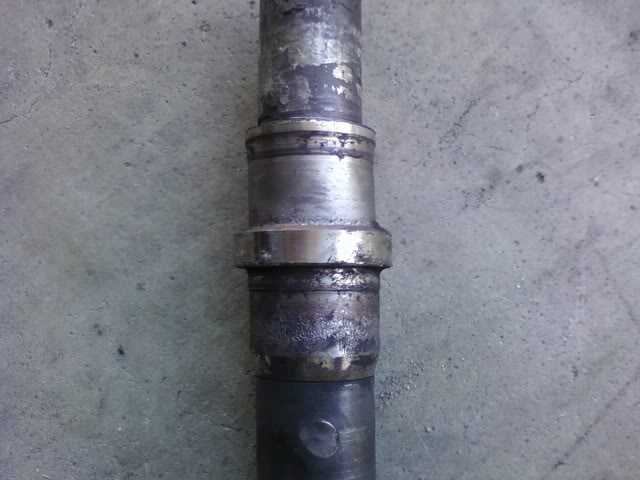

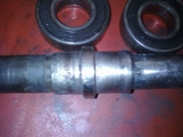

Its hard to tell by you describing a "noise" take the shaft off and take a look at the bearings, if lots of metal dust comes out thats no good. If the bearings go they will most likely take the shaft with them, unless you catch it soon, i'm talking within a week.
When my bearings died i was still able to make 6psi of boost.
japanman took some pics of his old shaft when he replaced it, just want you guys to see just how damaged your shaft/bearings can be. This is the worst I have seen so far.
