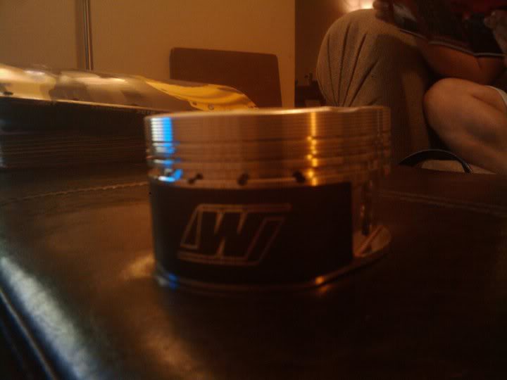

mine's being put in this weekend... Wiseco 8.8:1 pistons, K1 rods, ACL race bearings, Stock head, ARP head studs, Cometic head gasket should mate up well with the turbotoyota's kit... only thing i have planned for the future is standalone and return system...
last time i ever saw them
