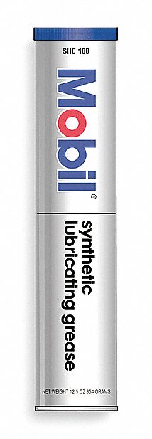

FYI,
If you are getting your bearings at grainger, pick up a tube of the mobile high temperature synthetic bearing grease. Mobile has performed well for us in the past and should help again thermal breakdown of the grease when the engine bay really heats up.
