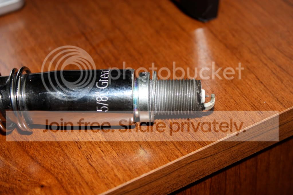

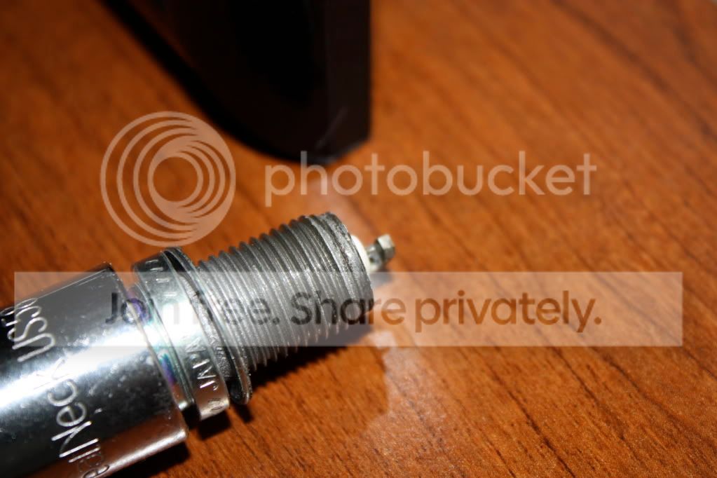

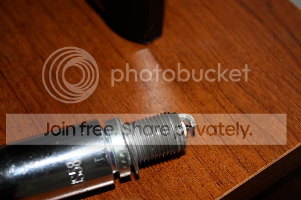

lol i just put em back in they looked good just a little soot around the top of the treads and the tip had some whiteish greyish deposits

pics coming

As far as I can tell the plugs look fine.
Does your F/IC have the resistor mods?
