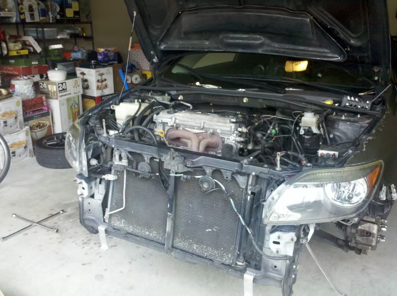

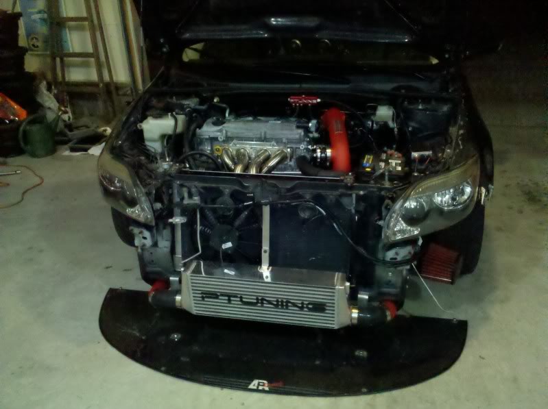

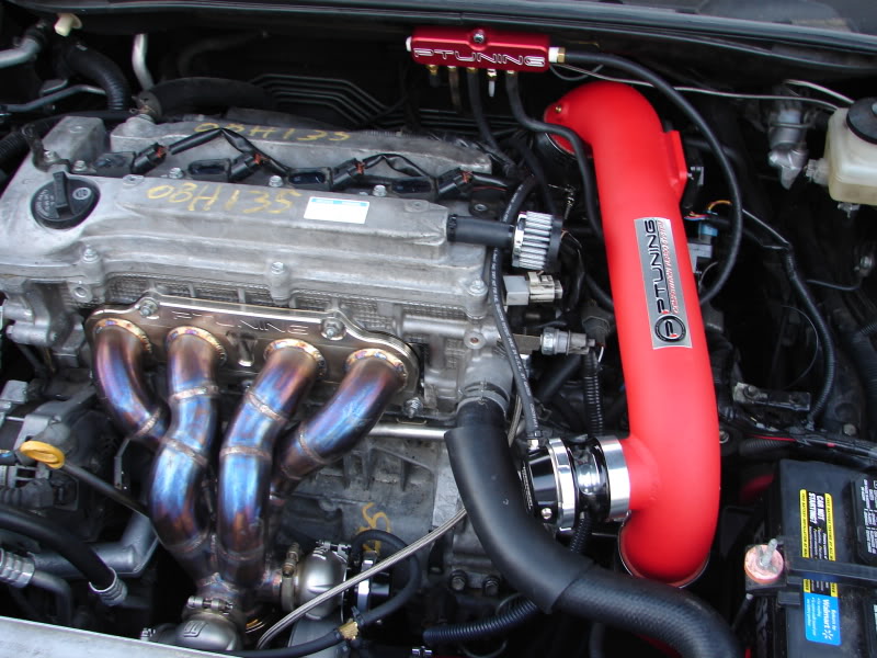

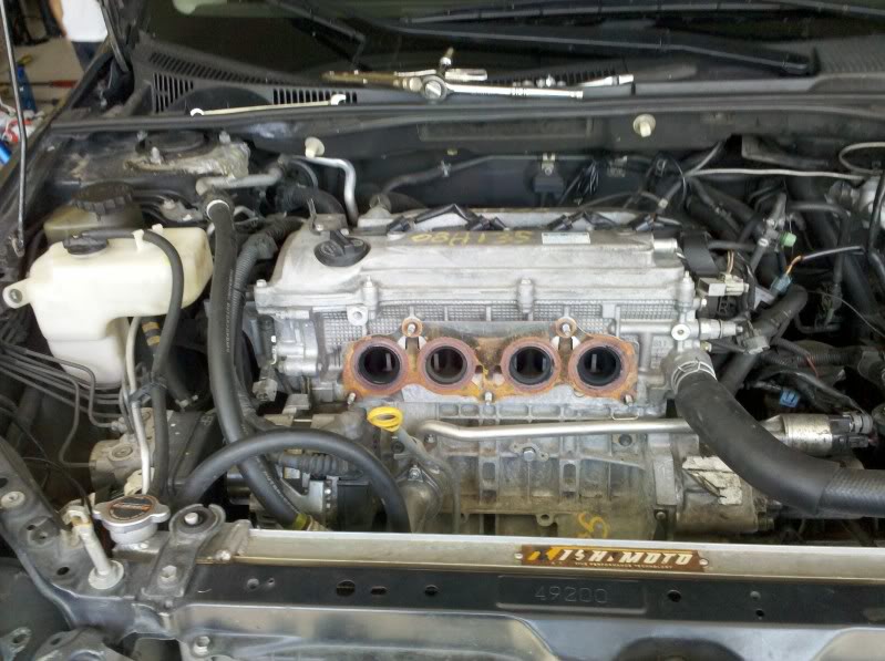

Couple of weeks for tuning. I talked with you about going ahead and getting the PTuning 900cc injectors, but I have a deadline coming up (track day), so I'm going to go with the 700cc injectors and a Dwerks 300lph pump. That will suffice for now since I'm just running 11lbs of boost to start with.
I've had to wait till 8pm to wrench on it during the weekday, or wait till Saturday's to do anything. So it's taking a little longer than most installs..lol.
The Spec SS instructions are included which you can follow 98% of those same instructions for the Spec RS setup. My only recommendations in the order of installs is to leave off the hot side ic pipe and the front WG until the very end. As mentioned though, RS instructions are not within the SS of course.
The water line hook up was pretty easy. V-band hooking up of the exhaust when you have only two hands is pretty cumbersome but not impossible. LOVE the new tip on the rear.
-Old exhaust will be for sale (Full 2.5 all the way through, no res, no cats and ends with an Aero Turbine muffler)
-I have a PTuning 3" S-pipe for sale as well (I didn't need it because the PTuning Downpipe is two-pc and connects to the mid-pipe.
Umm...other thoughts...
Couple of vac lines I need to hook up...charge my battery since it's been sitting...install spark plugs....wipe all piping down with alchy....drop oil in and she should be ready to test start and check for leaks.

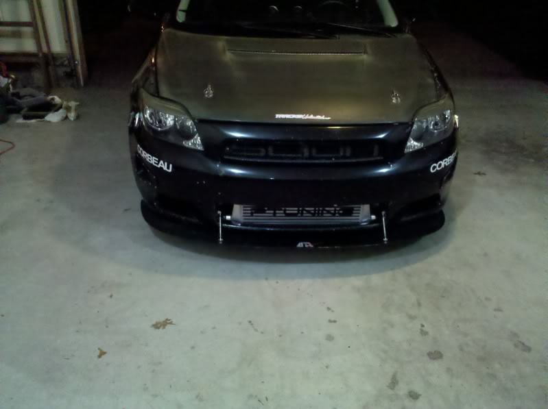

Recently found a shop that I can trust that's here in my home state, that I can take and leave the car there for them to work on. Body will change next season to accomidate the 285f/265r wheel/tire combination. These guys will also either install my Auto Power roll cage, or build me one (haven't decided which route I want to go yet with that, bolt-in or welded in).

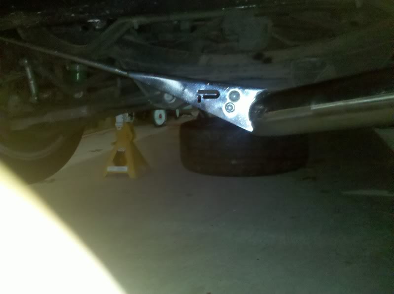

Travis, looks like you installed the mid section of your exhaust upside down. hehe! Hangers should point downward. We get calls all the time about that.

lol he did. i only installed mine correctly because you pointed it out in somone else thread a few years ago.
No wonder I'm hanging lower than Kevin's V1.....lol. Thanks for the heads up, now I can stop scraping over speed bumps...hahaaa. Brian, Kevin and I waste out tonight so I was comparing the way my exhaust was to Kevin's.
