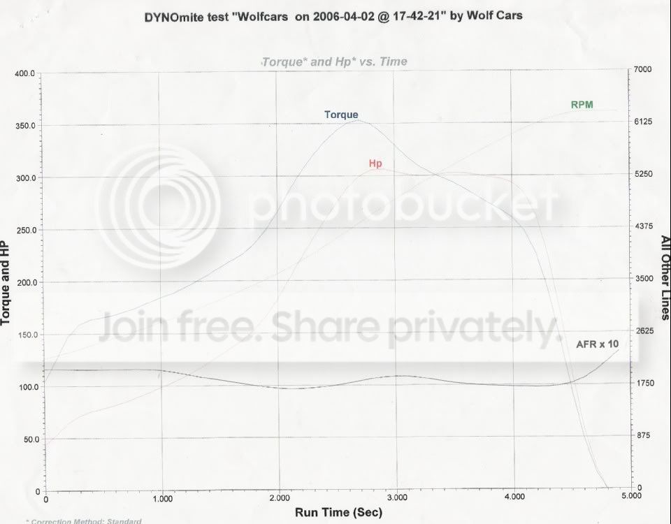

This was on my kit at 14 psi, stock motor, as you can see the power band decreases at the end because of wastegate problems wich the boost was coming down to about 11 psi by redline, and also on a not so efficient turbo. The car has been in the works to try and make plenty more of power.

wats ur setup? boost tapers down in any turbo setup, so its normal to see lower boost levels at redline.

boost does not taper down in any setup. it depends on what turbocharger you are using. the correct turbo setup will allow you to pull great boost for whatever powerband you are looking for...

Nice numbers, here is a better version of your graph..not as bright and readable for me.

The turbo was a .42 trim compressor and 40 exhaust side thats why it wasnt being too efficient.

By efficient, you mean the lag right? Cause it looks like there is a good deal of turbo lag.
