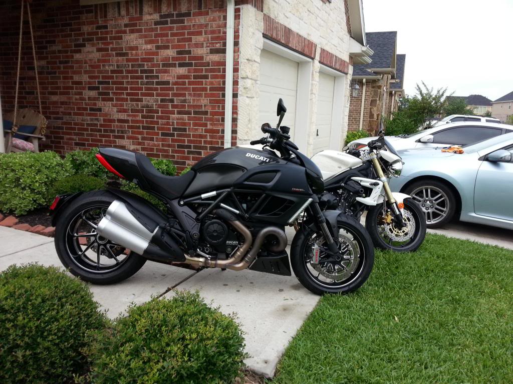

Shoot forgot about this thread, lately I've been busy adding a new stable mate to my street triple

that's the kinda azz a guy can just stare at....lol

been hearing that a lot lately. No homo :-P

Love me some street fighters. More pics of the triple.
