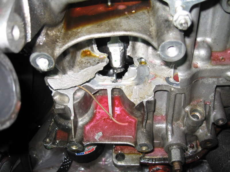

For reasons I will be unveiling later, I had to do an engine swap on my baby.
Hey Mike, I found out what happened. Here are some pics of the old engine and new toy going in.
Old engine with 67,000 miles

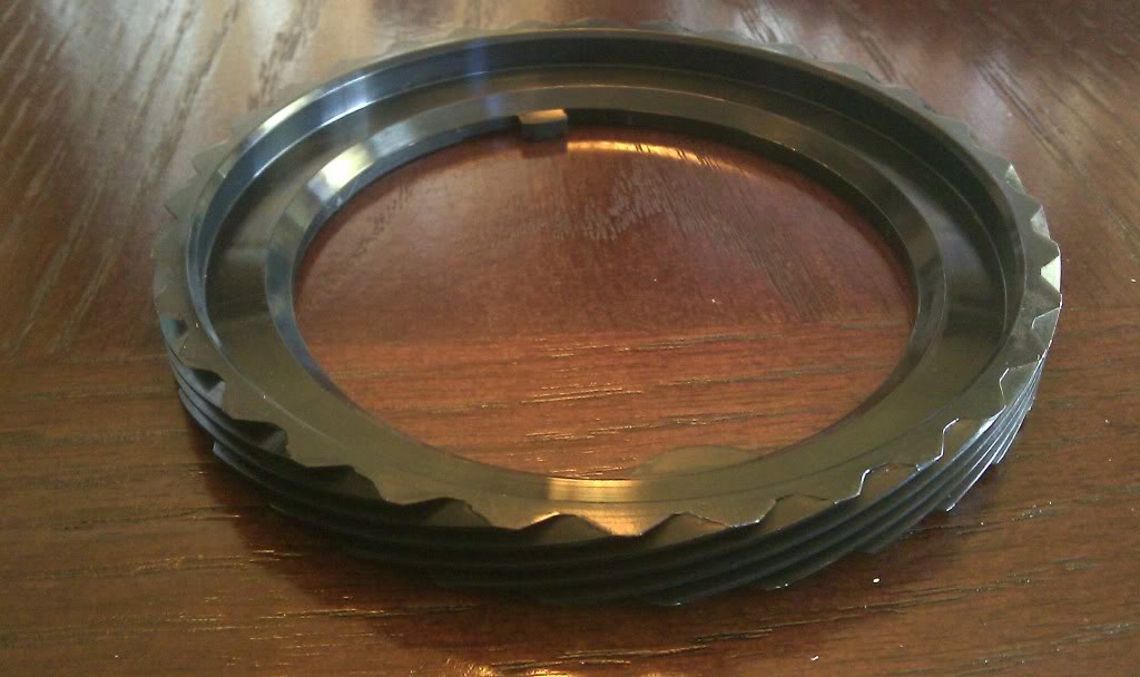

Quaife LSD thanks to Autotech! Heck of a deal.

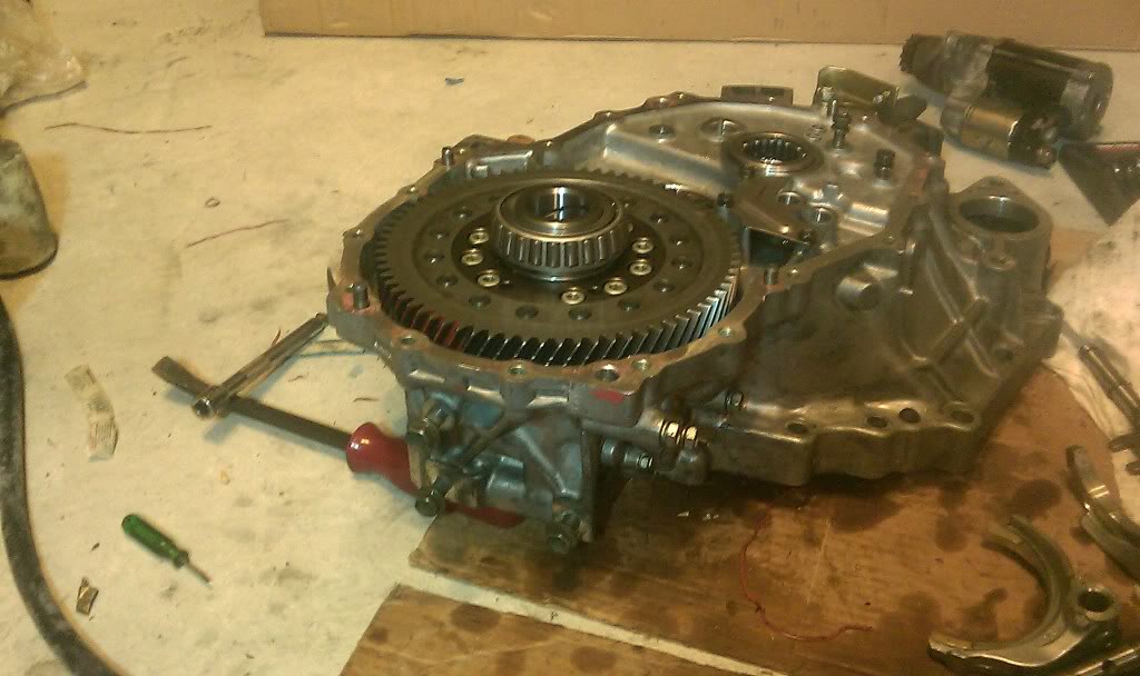

Old Differential

Sweet, moar pics as you move on with project. How sweet of a deal exactly did you get on the LSD? BTW, that block will be fine with a smidgeon of JB Weld.

Good luck Carlos! I'm glad to see everything is working out for you! That hole you made in your block is pretty nice by the way, haha. You guys down there in Houston keep me inspired.

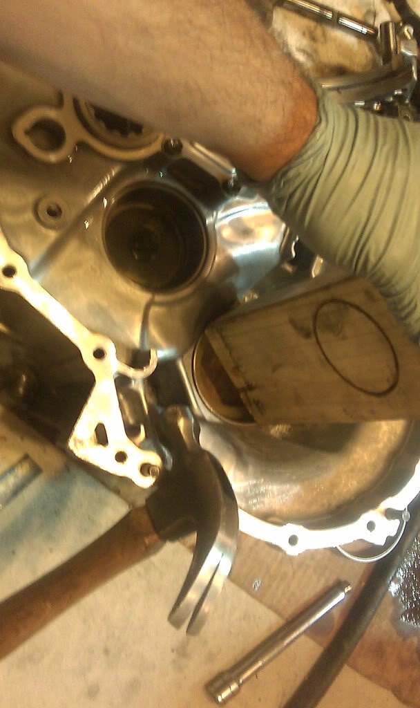

Here's some more:

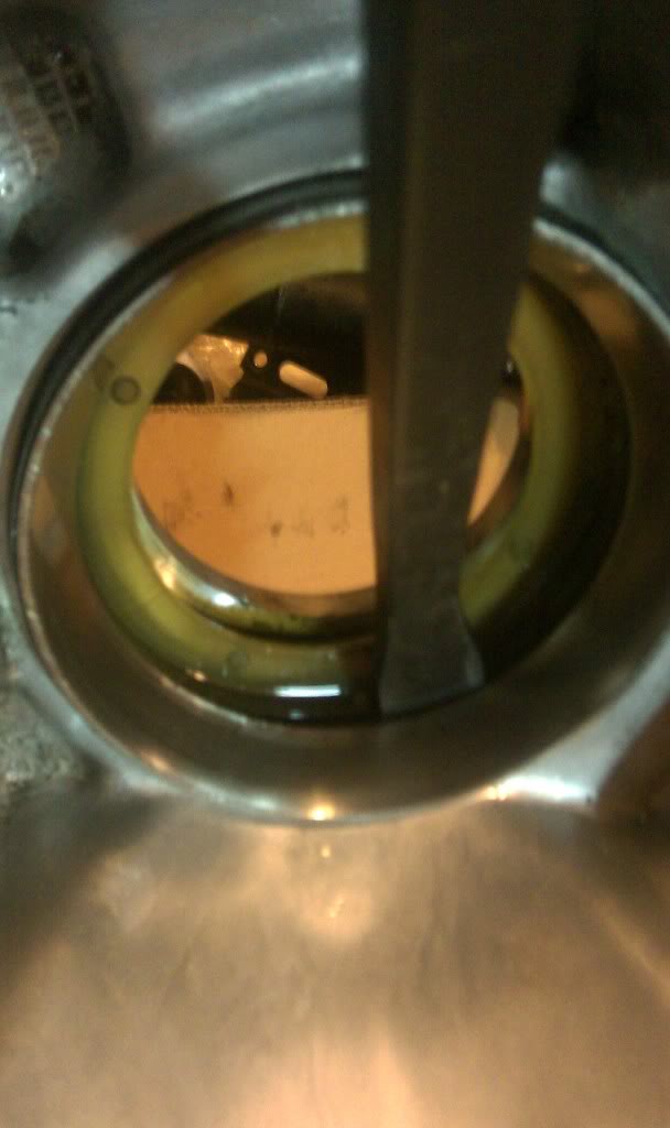

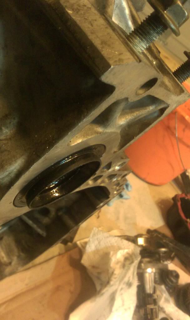

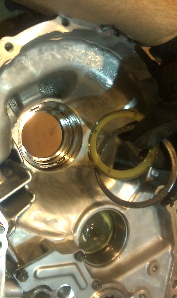

To get out the driver side axle seal and lsd bearing race, tap out with anything that might help. The install kit comes with this seal anyways, so if you break it that would be no problem. One thing to note is, once pressing back the new seal and you get it flush with the housing, go in an extra 1/8 inch. Or better, take note of how far in the old one was.

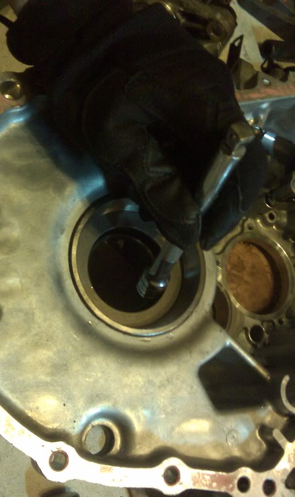

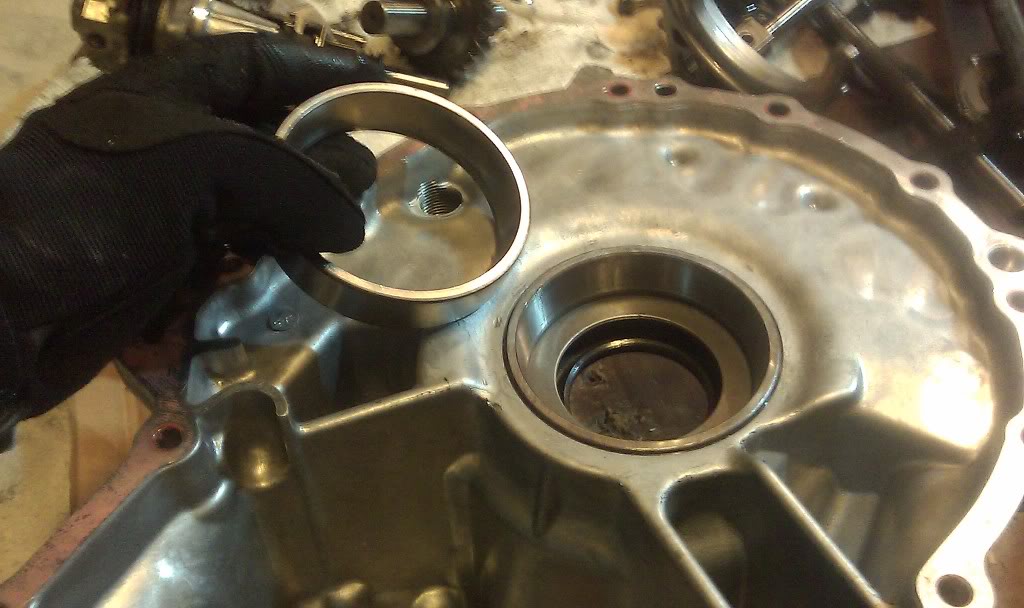

To get the passenger side axle combo I used a sears pry bar, reason being was that there's a flimsy plastic oil blocker between the oil seal and lsd bearing race.
Cleaning up the housing with throttle body cleaner lol, only thing I had.

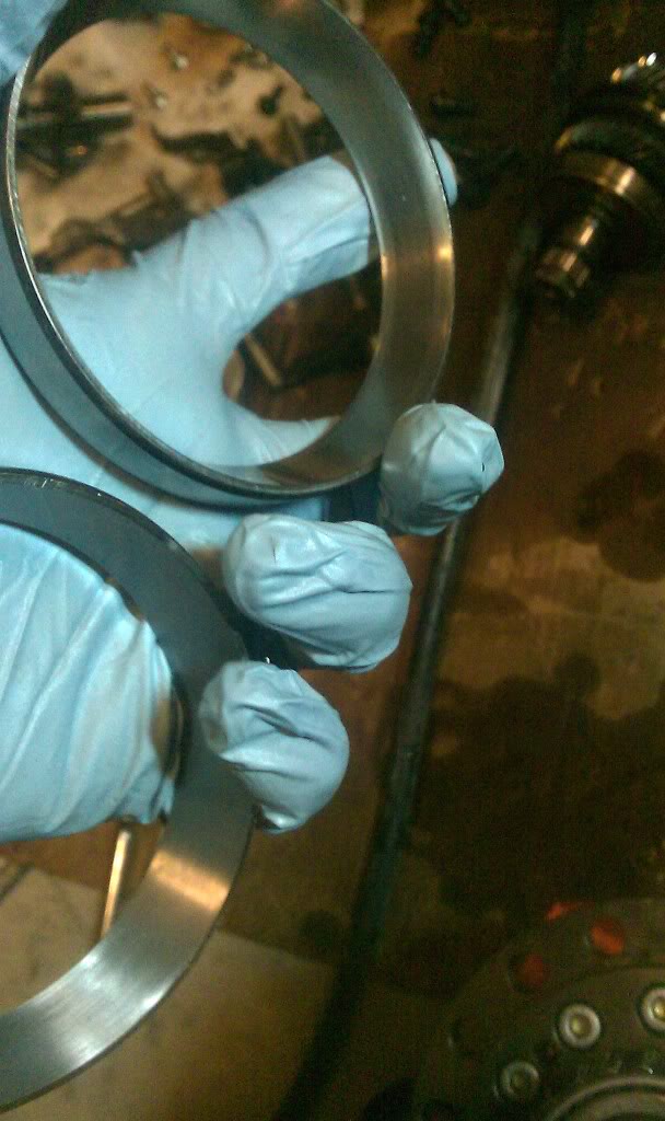

Old and new pass side lsd bearing races, notice the wear?
