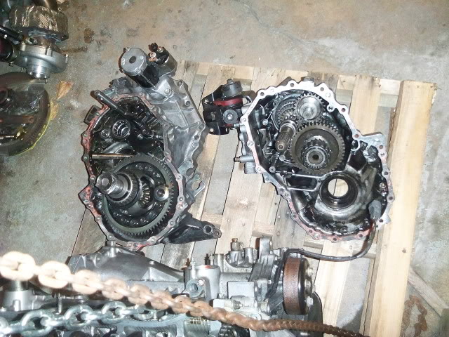

Old tranny will be kept as a spare i guess, gears are ok minus a few rounded corners, synchros are dead though. Axle is still stuck in there in those pics, we tried everything to get it off and eventually ended up grinding it.
