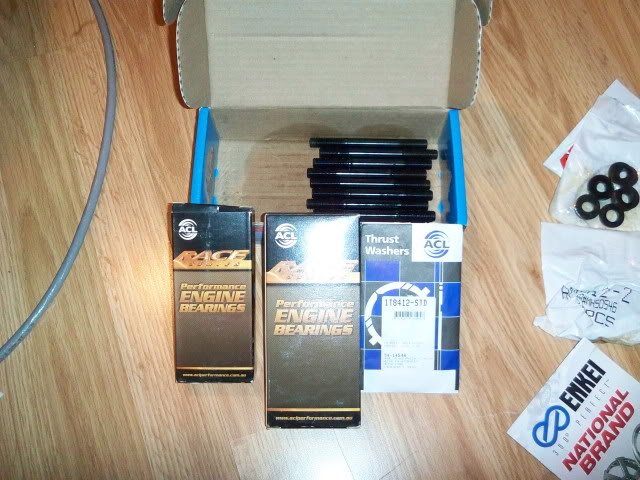

More goodies arrived today:
Should be a promising build for sure.
Old Jan 7, 2010 | 01:57 PM
  #50
ElevationTC's Avatar
Posts: 4,156
Glad to see you took my advise dave! Im sure paul had all this to you in no time!
The race bearings and main studs will sure be a nice touch to your build! Let me know if you have any questions when it comes to your fuel return setup!

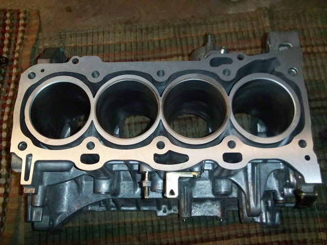

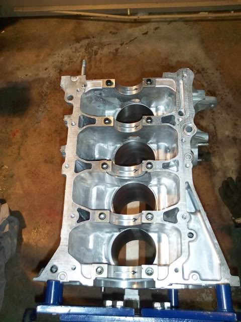

Got everything back today, notice the 2 inner cylinders are re-sleeved, ran into some trouble and needed to get those redone. Already put in the arp main studs and torqued the caps, back to the shop for an align hone on wednesday.

Old Jan 13, 2010 | 01:16 AM
  #52
GQQSE13's Avatar
Posts: 5,942
From: Decatur, IL
damn dude, i didnt realize u were doing a full build, thought just doing a simple bolt-on turbo kit or something, lookin good so far; hope to see it this summer
Posts: 4,156
Dude the sleeves you swapped in look much bigger then OEM
Cheap sleeve job ftw!
Old Jan 13, 2010 | 03:23 PM
  #60
gompka's Avatar
iTrader: (5)
Posts: 1,712
From: Chicago
They are much thicker, one of them the aluminum around the sleeve was really corroded so i needed a really thick custom sleeve to fit the space, got it from LA sleeve btw, the other cylinder then went out of round so had to do the same thing.
