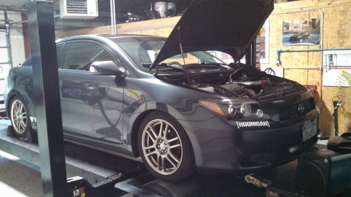

Welp... it has begun. On the anniversary of owning my tC for 2 years now... she's at my main garage getting the necessary checks and fluids done to start the build!! After a nice bath... she was put on the lift. Won't get the car back until tomorrow... so that sucks.
Monday is dyno day and I will be contacting you paul!!
Have a good weekend folks!!

Nice "Fire Station" themed shop.
I kid, I kid.
And nice snow blower for sure.

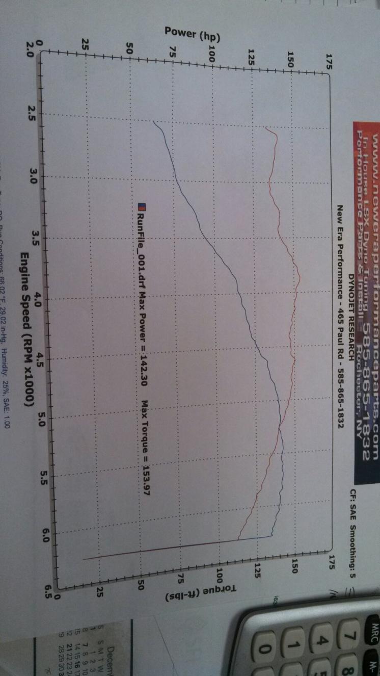

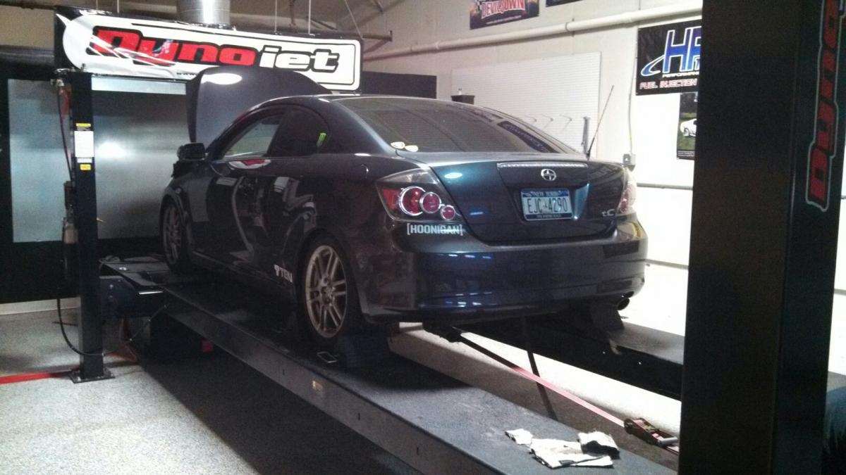

Alrighty folks... the BASE LINE numbers are in...
First... the leak down test came back great!! The car (motor and body) have 72,497 miles under her belt... and the numbers came back as this...
Cyl #1 - 6%
Cyl #2 - 10%
Cyl #3 - 10%
Cyl #4 - 9%
... So the motor has a clean bill of health!!
Talked with Paul again in-between getting the car back and my dyno appt... worked some more things out... Dezod S1 kit is where I'm headed...
And now on to the dyno... again... these are BASE LINES!! We did 3 pulls, the second pull didn't record, but no big deal. Another huge thanks to the guys @ New Era Performance for helping!!
On a 4th gear pull... she mustered Max Torque = 153.97, Max Power = 142.30... run sheet attached.
Mike (Owner @ New Era) said my old cat was shot and holding it back a bit... plus on a stock clutch, would be losing out there too... so that's where the upgrades come in!!
It's a start... now just need to order the S1 kit and get wrenching!!

That's awesome man! Really happy to see 142hp out that baby! That's not bad at all. I've never seen cylinder numbers come back like that but if I do the math, that sounds about right. Great to see man, and that old cat, bye bye, and that old clutch, bye bye.
So is it a good thing regarding the cylinders or bad? hahaha
I'm happy she hasn't lost too much regarding the power and torque... she still gets up and goes when ever I wanna have a little fun!! She kept up with an SS Camaro on the highway @ 133 mph!! hahaha

With the cylinders, was this a blow-by test or a compression test?

It was a "leak down test"... not a compression... but I'll get one of those done too just cuz Paul asked for it...
