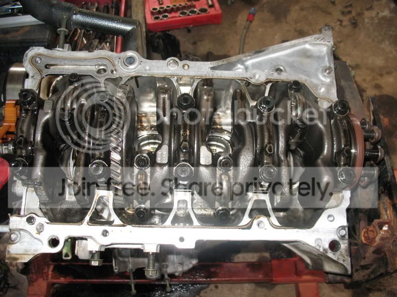

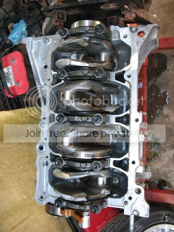

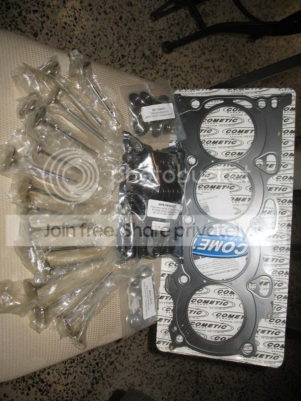

Just keeping you guys inform. This are some other parts and mods that we are installing.

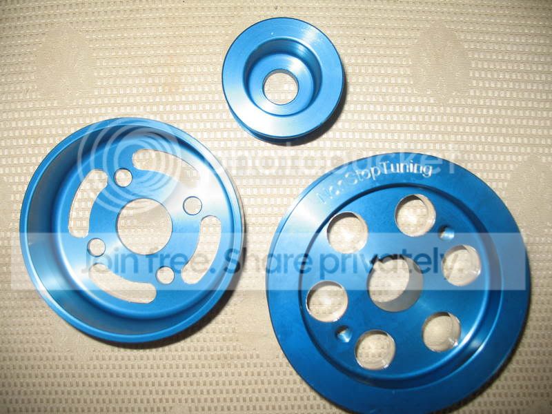

NST pulley kit

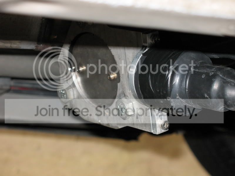

QTP 3" exhaust cutout

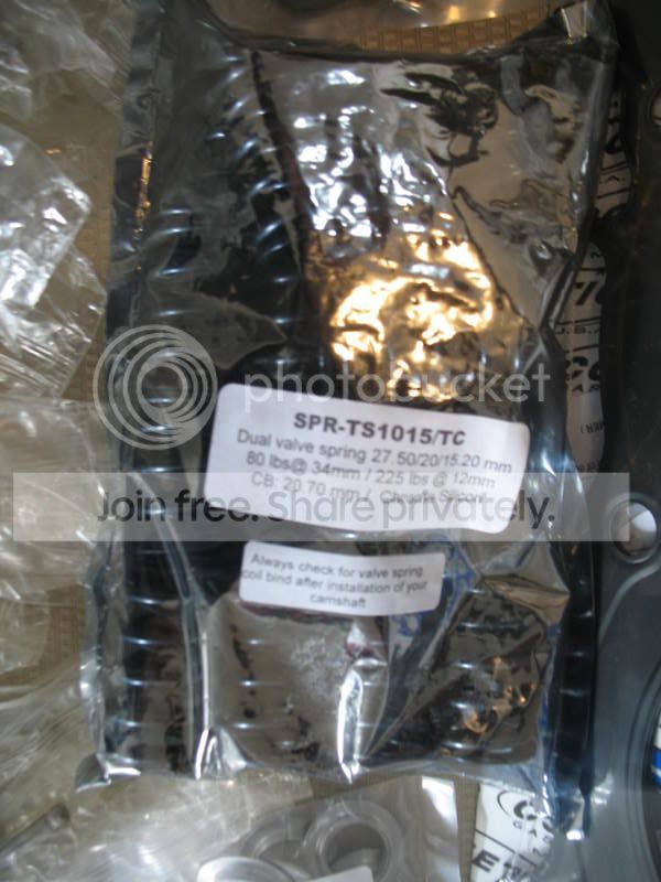

Valve springs and retainers fron Dezod
Cometic head gasket and valves from Dezod

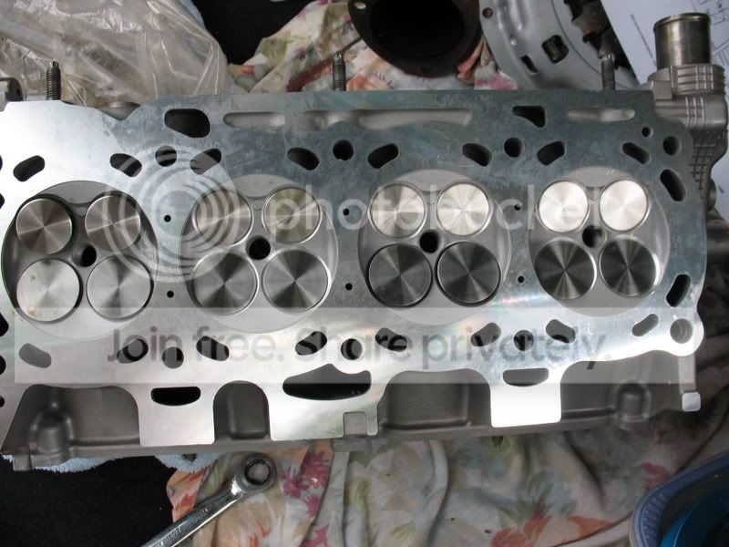

Port and polish head ( with some other tricks)
New FMI and modified front bumper

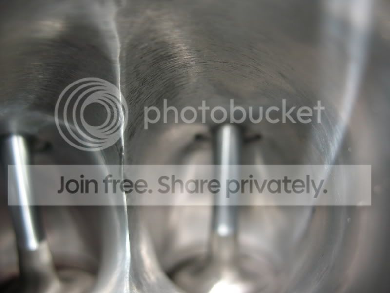

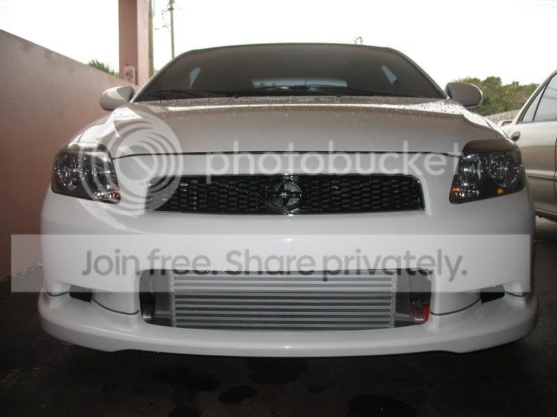

And ....What you guys think about this??
before...
And after......

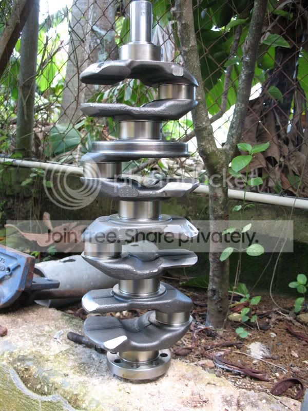

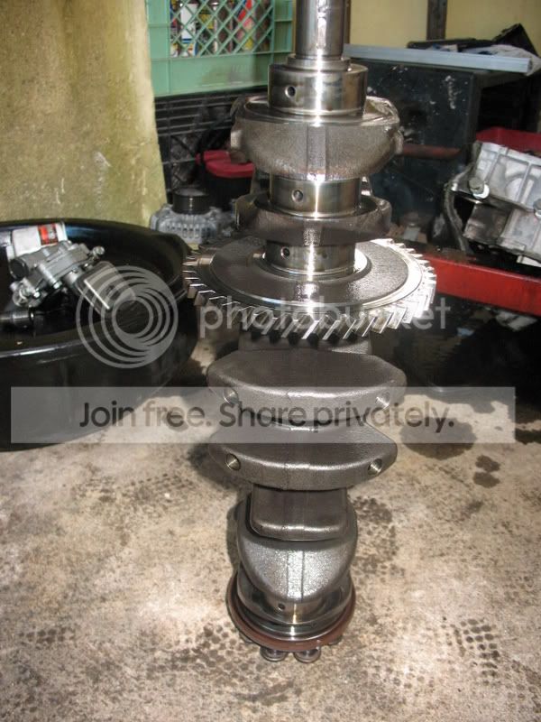

Also we have a Fidanza Flywheeland there it's no balance shafts on this engine no more. This are just a few. More to come soon!!!!!!

word of advice on the QTP cutout. take the screw out of the plate and put some threadlocker on the screws. overtime they will vibrate out

Whoa. Whoever did the porting I would not be happy with. Very shaky hands. Otherwise looks good! I'm sure you'll be happy with it when you're done.

yea, i still don't understand why people are knife-edging intake ports...
I will!!!!Thanks for the advice.
I was looking at those too... Very uneven but its a port n polish job. Looks like this is gonna be a cool build when its all done

For you more knowledgeable guys... How do you feel about the pulley kits? I've read good and bad things about them on the tC. Things like it can mess stuff up (can't remember what though). Any advise on them?

The things that people say the pulley kit can mess is the oil pump (on the 2AZ-FE is right behind the crankshaft pulley) and is only the crankshaft pulley, not all of them.
I will install the pulley kit but I sent the new NST crankshaft pulley along with the crankshaft, flywheel and pressure plate to be balanced at the machine shop.
Some people say there are problems associated with the non-dampened pulleys and with the removal of the balance shafts. We have both mods on this engine. so only time will tell!!
