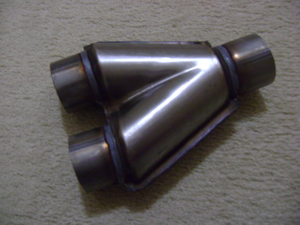

Well here's why the build is also delayed a bit longer.
What just came in today!
Here's an idea of what it'll look like... I used Paint lol, not PhotoShop! Haha.
1.
2.
3.
Turns out there won't be enough clearance under the car for the dual
He would have to make a insane bend for it to work. So I just decided to keep it a single.
But my shop will just reimburse me for the y pipe and extra muffler I purchased!
Should be ready by tomorrow hopefully!
