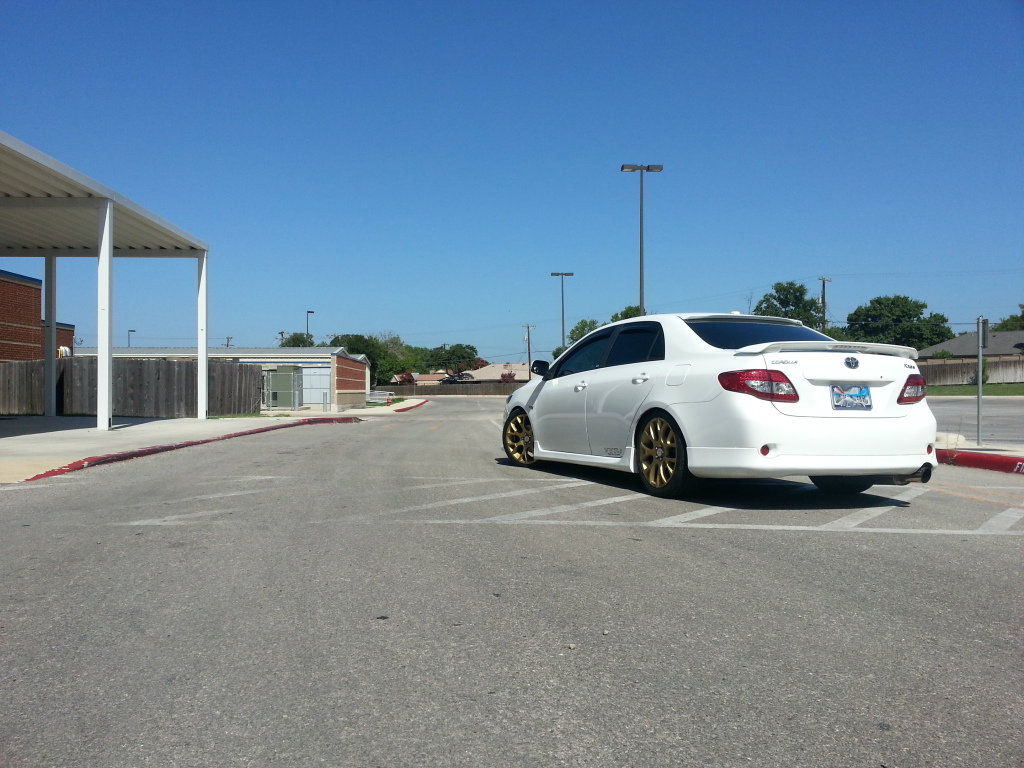

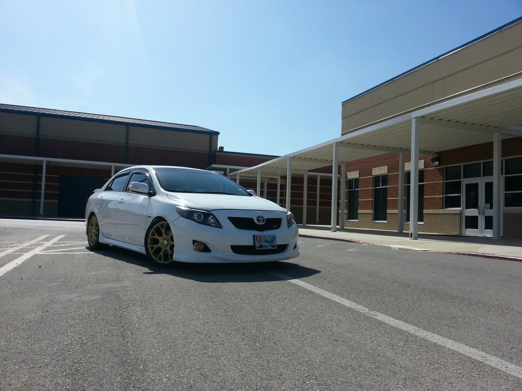

Here are a few recent pics of how the car sits.

Purty Cool for a G'ma car!...
I have owned many Corollas of different years before too.
