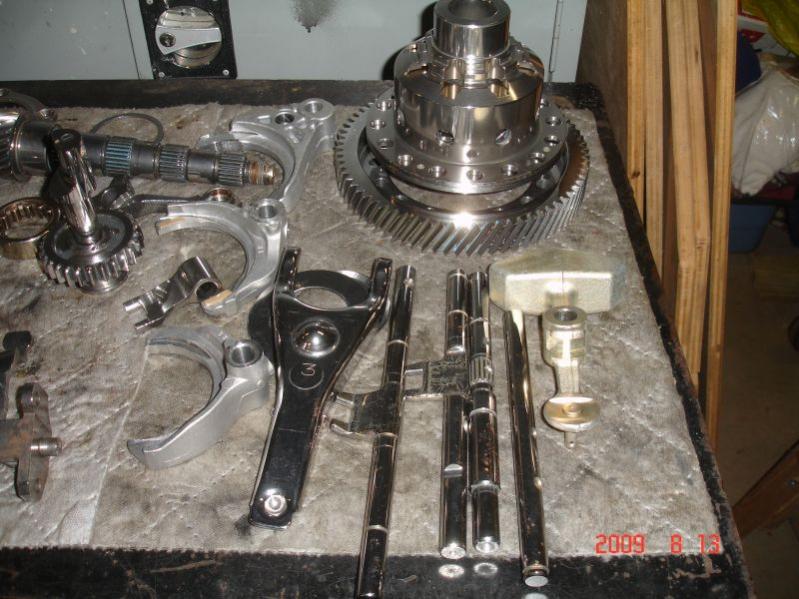

· Cryogenically and REM treated (All Gears, Shafts, Bearings, and LSD)
· O.S. Giken LSD

that's a nice build! May I suggest going down on the thickness of the tranny oil. Eventually you might encounter shifting problems with that thick of an oil. The 75W90 severe gear will have plenty of protection being a thick 90w GL-5 oil. Also being lighter than the 140w will help with the cooling in the transmission. If anything, at least give the 110w a shot.
Good luck man!
Old Nov 25, 2012 | 09:53 PM
BlackKnight's Avatar
Music City Scions
Posts: 1,372
From: Nashville, TN
can't do, the gear oil weight is O.S. Giken's recommendation also remember REM treatment reduces friction thus reducing heat.
Sent from my SGH-T999 using Tapatalk 2
