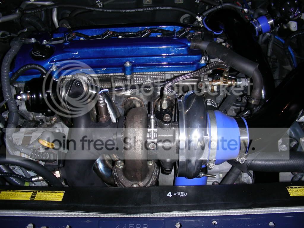

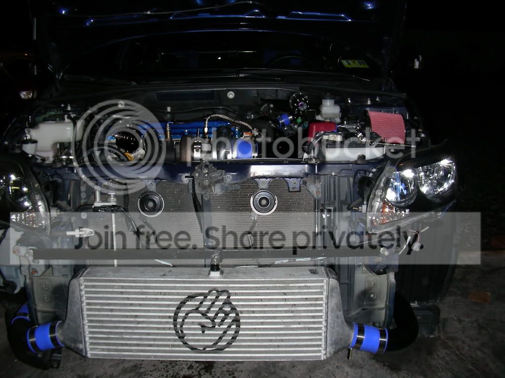

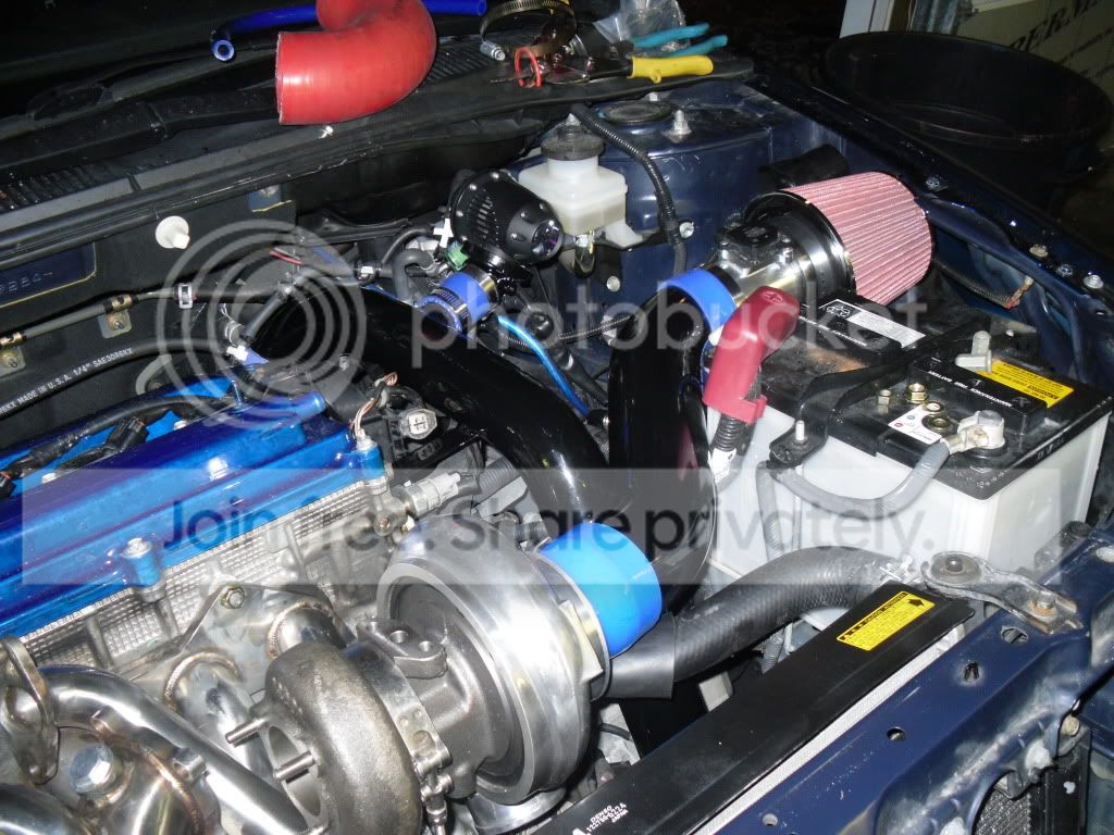

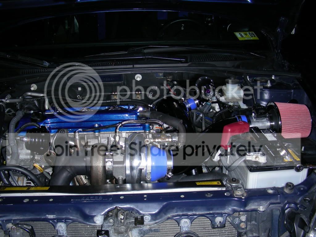

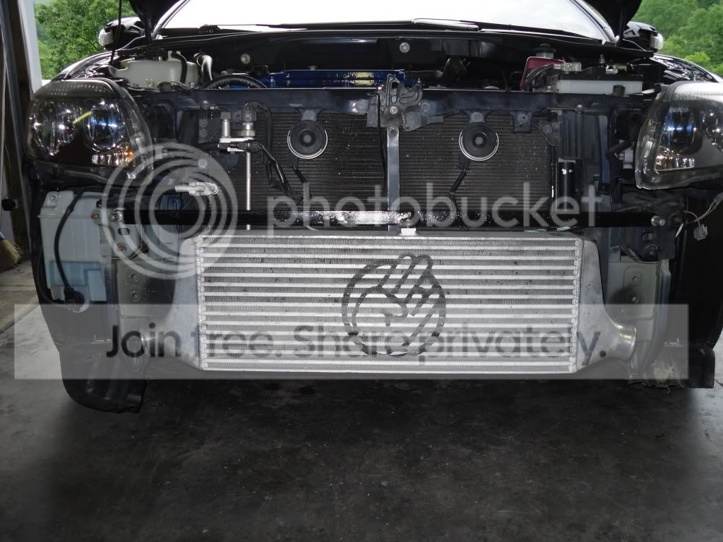

I was running the Dezod S1 kit, but a local shop that is known for modding Subarus wants to get in on make turbo kits for Scions. Well anyway I couldn't pass up the offer so they currently have my car and I should be getting it back by Thursday. After I do test the reliability of the kit the will be offering them to the public. Anyway here are some pictures.
The intercooler is just a mocked up intercooler.

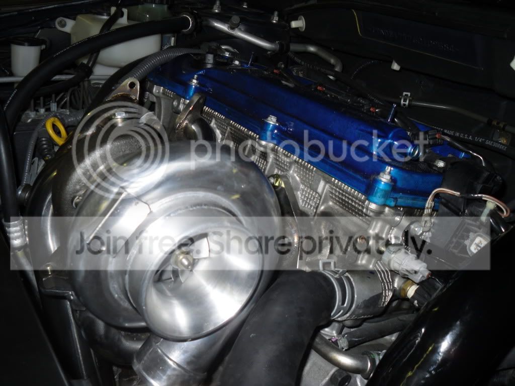

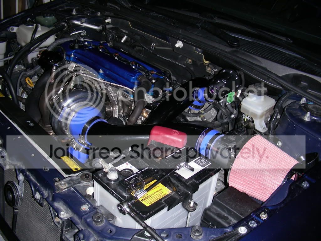

Their kits are going to come with Garret Turbos, but I went with something different and went with a Mitsubishi TD06/TD07 Hybrid that they made. It is very similar to a Greddy T67 with a different hotside. The compressor is right between a 30r and 35r.
Sorry for the pic it's from a cell phone.
I will post more pics in the next few days once everything is done and hope to have a dyno sheet up within a week or so.

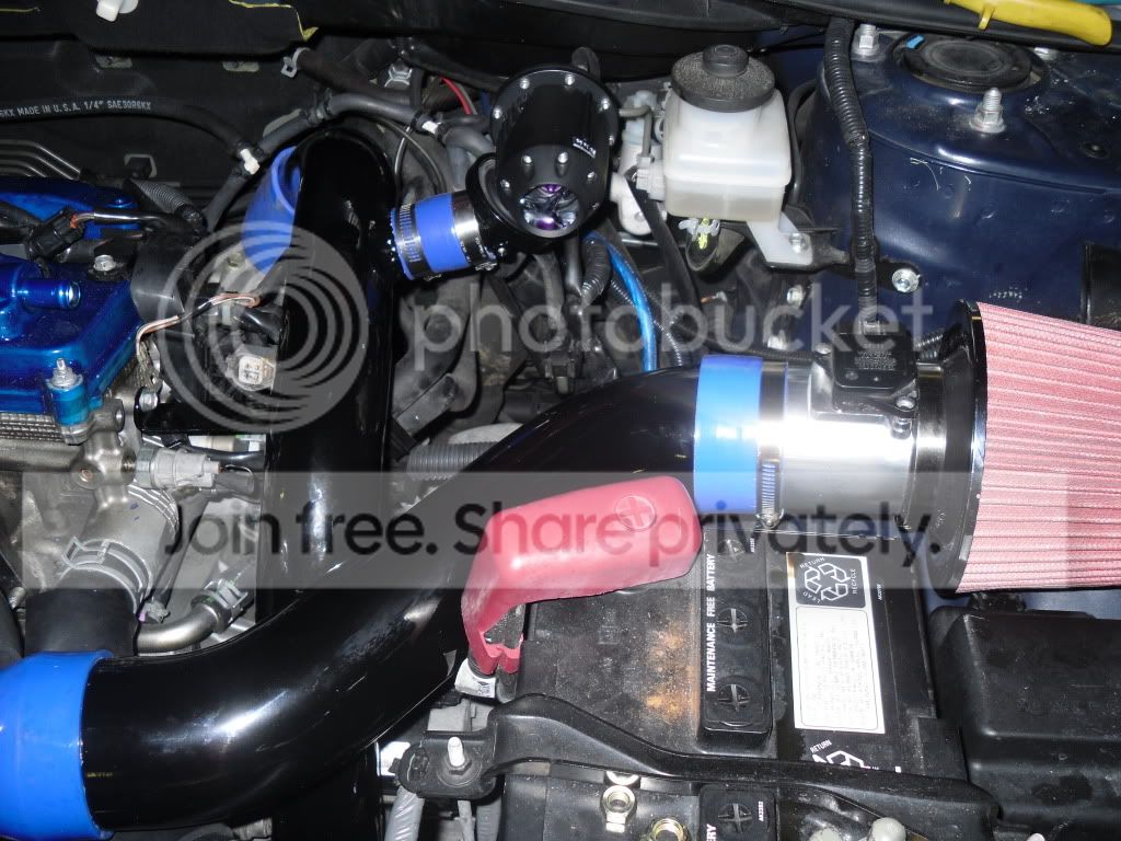

looks good, its gonna be interesting to see a new turbo system on the market.. and oh that bov is just a mock install right?

i cant tell from the pic is it a El or a log mani
Old Jun 3, 2009 | 04:11 PM
DezodDon's Avatar
Joined: Apr 2009
Posts: 782
From: Buffalo, NY
Did they eliminate the factory front bumper/crash bar?
Old Jun 3, 2009 | 04:37 PM
jsg93085's Avatar
Posts: 660
the mani looks like a megan one...
Old Jun 3, 2009 | 05:30 PM
FMTC08's Avatar
Posts: 442
From: Central, NJ
Old Jun 3, 2009 | 05:57 PM
2006bluetc's Avatar
Posts: 733
From: St. Albans, WV
Ace- The bov is just mocked up. On the production version it will be welded onto the pipe.
Gunnist- As far as being certified what do you mean .. also I check exactly how long they have been tuning and modding, but I know it has been awhile. Until they get this kit completely done I will be relaying messages through them.
Dave- The manifold is an EL manifold
DezodDon- they did eliminate the stock crash bar however the fab a new piece of steel in it's place so you still have some support.
JSG93085- The manifold was made at the shop. I was there when they were working on it so it isn't just a manifold they bought. I am not even sure what the Megan manifold looks like, but I know this isn't one.

yeah i figured that bov isnt the final location, it would looks funny if the bov sits like that and would probably surge a bit.. blow thru map setup would be a nice option too so you can just slap a filter on the compressor inlet and get better spool

its a megan racing top mount replica thats exactly the same one i am selling.
