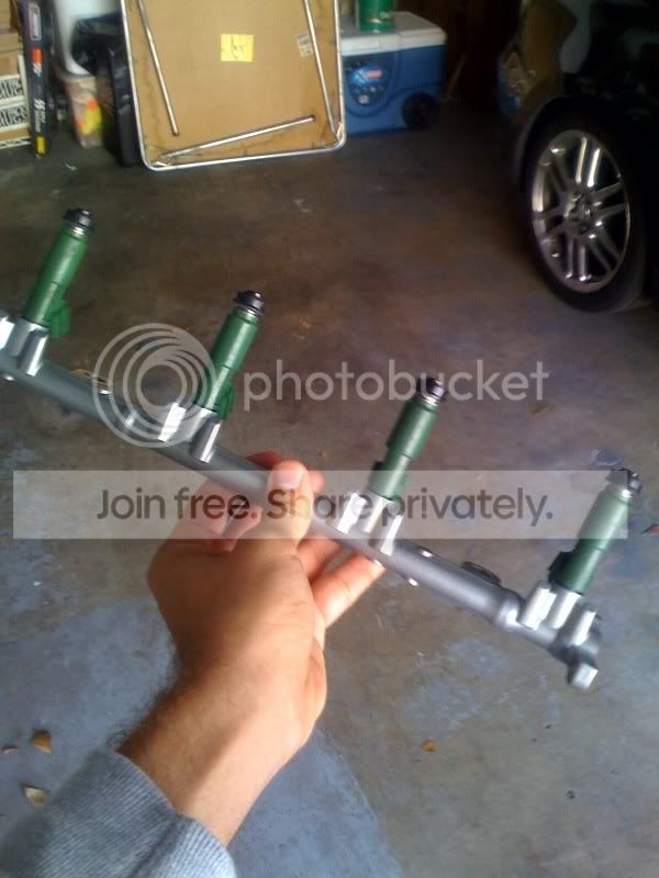

def. gona be watching this im designing a fuel return setup now too i took out my fuel rail the other day, trying to decide if i wana drop money n get an aftermarket one or just drill away at this one.
heres my rail w/ my 550ccs
i have the walbro 255 already, gona look into getting rid of the 550s for what? im thinking 750cc its gona be a built motor so im looking to make as much power as i can so 750s may be not what im looking for but i heard going bigger than 750 makes tuning our cars tough. next on the shopping lists an aeromotive fpr def watching this thread lets make it the ultimate guide to the ultimate fuel setups for our tCs on boost.....n/a people go away!! lol jk jk
