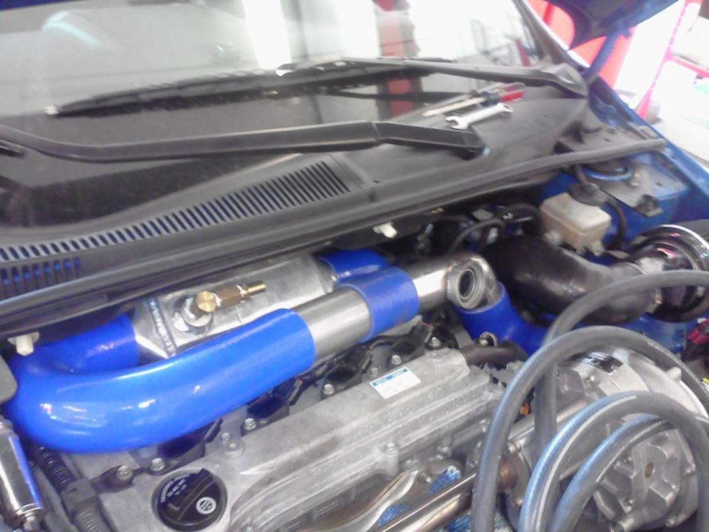

Nice build you totally copied me though lol

that setup looks really simple but alot of work lol nice!
is that a air to water intercooler or air to air? where do you connect that port to on top with the gold?

I got the motor apart and turns out more oil than I thought was getting into my intake from the supercharger. I knew the seal was starting to leak and was going to replace it again but didn't realize how bad it was. The intake tubing showed no signs of oil but the throttle body, intake and intake side of the head showed signs of oil.
I am relieved that it wasn't an issue with the intercooler but obviously bummed it had the issue. I'll get my bottom end apart tomorrow and hopefully its just rings but may be replacing pistons too. The other good news is because of the oil I was probably leaving some power on the table because of lowered octane from the oil.
