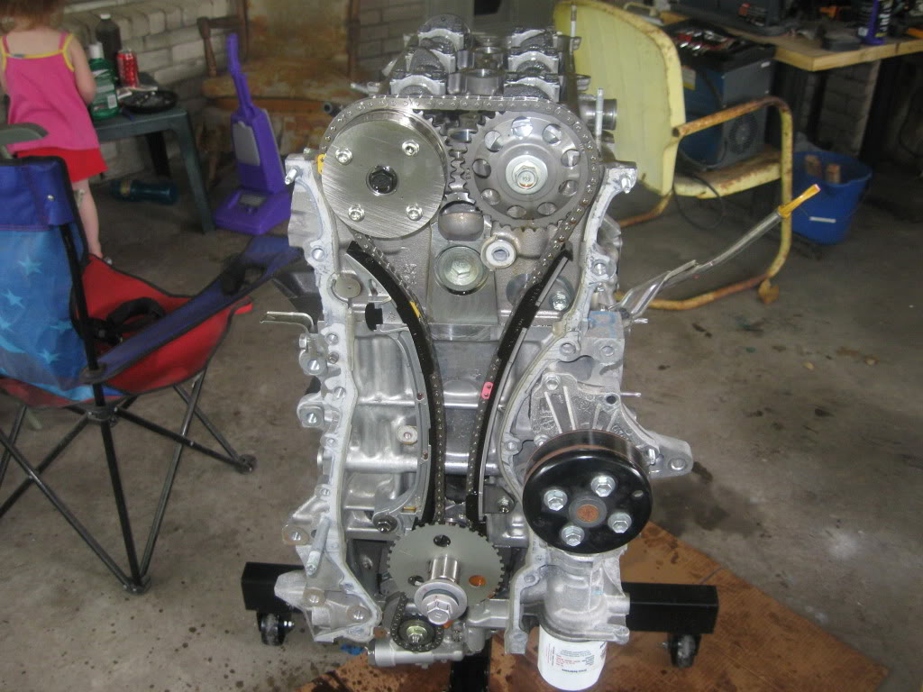

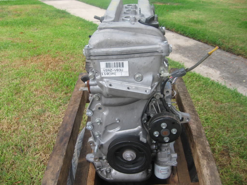

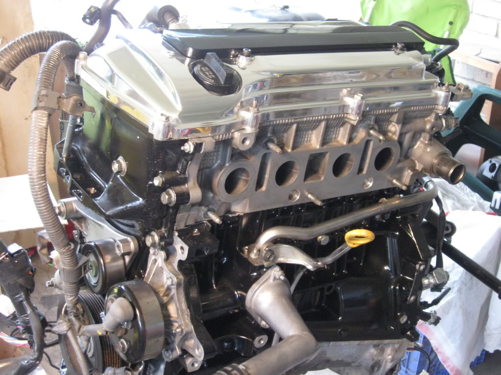

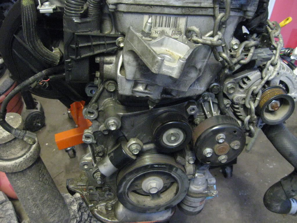

Old Mar 30, 2011 | 11:38 AM
crush02342002's Avatar
Posts: 11,271
two of those pics are not of a tc but of a camry..guess which ones and win a prize

lol bottom 2 camry?

im gonna guess the bottom 2 are camry motors because they have the same oil filter lol
only thing different i can see is that pink chain link
hmm also the indents on the engine mount on the chain cover

I wouldnt go by the oil filter...lol but yes the bottom two pics are of the same engine though. (good eye)
on my 07 tc engine the timeing links are gold. 05-06 tc engine i did they were yellow. neither i remember had a pink chain link but the 08 camry engine did.
soooo...winna winna chicken dinna

Originally Posted by 1slowtc
lol bottom 2 camry?
you sir are full of win

Side cover mounts are dead give away!

another difference between model years: 05-06 tC had 9.6:1 compression and 07-10 had 9.8:1
