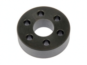

I would recommend also changing out the Coupler due to the fact that it also starts to wear down. You can find some on ebay by typing Supercharger coupler. It will not say it can fit a Scion but it does. I brought one for myself and it grabbed the 3 pin bushing tighter than the OEM.
Attached Thumbnails s/c troubles-coupler.jpg
