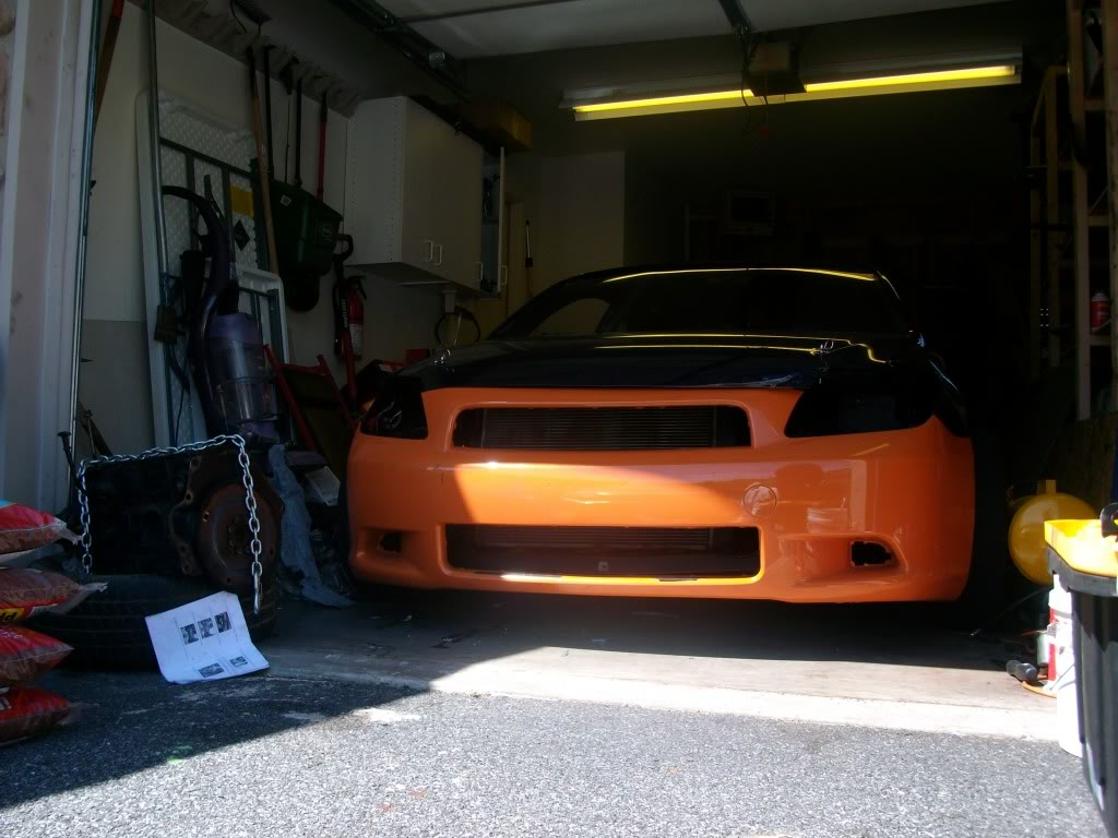

Old May 6, 2010 | 07:46 PM
  #42
kradstct's Avatar
Joined: Dec 2008
Posts: 403
From: marysville pa

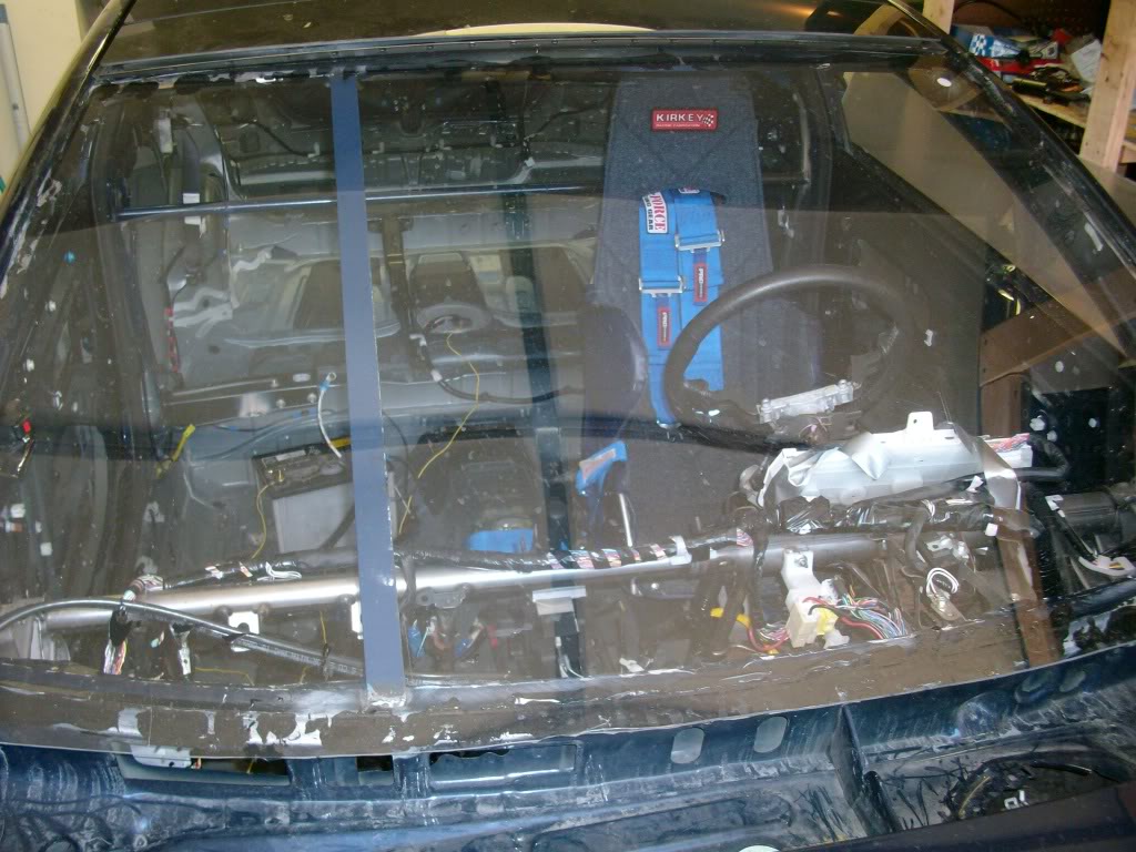

Old May 6, 2010 | 07:54 PM
  #43
kradstct's Avatar
Joined: Dec 2008
Posts: 403
From: marysville pa

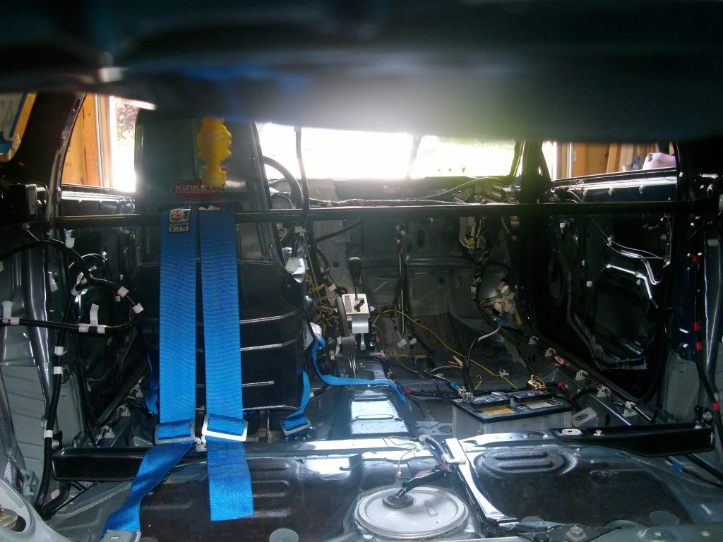

  #44
kradstct's Avatar
Joined: Dec 2008
Posts: 403
From: marysville pa
