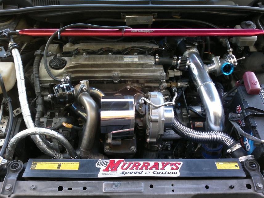

This is my setup before I KO'd
Ok sounds good GUNNIST14 and nice engine bay, that heat shield makes your setup look clean. It sucks that your engine blew (assume that's what ko'd means?) But I hope you hop right back on and get it running again
Only downside I think for heat reduction will be cost and an even more elongated not being turbo'd time lol.
