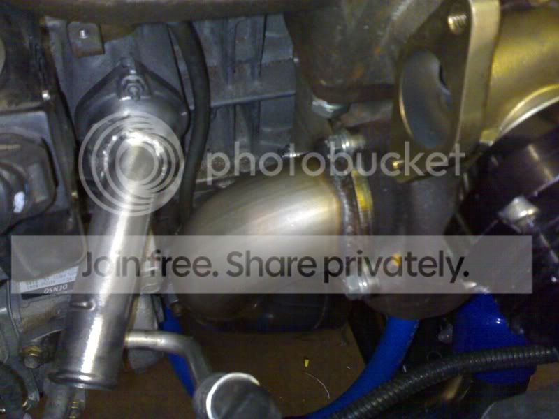

From: Orland Park, IL
I'm glad you guys are all supporting Treadstone, they make a good product, but not efficient.
After reviewing there website and staring at there downpipe for a a while... I realized... the Downpipe is what they call "Cheating the Tangent"
With the exhaust flowing at a high rate of speed, the smoother the flow the better. View the picture of the down pipe below.. As you can see, the way the downpipe is designed... the exhaust gas is directly hitting the curve of the pipe... you might as well have a downpipe with sharp angle bends. Ideally the downpipe should be cut so that is has a 90 degree bend. So the flow is smoother and not running into a wall.
Notice how the exhaust doesn't hit a wall, it travels smoothly into the downpipe.
Better Exhaust flow ='s more Power!
I don't mean to make treadstone look bad... They have a great product, I'm using there manifold, but some things could be better! That is the cause for everything.

I could care less....it put me at 249.4whp @ 7lbs of boost...pretty solid product if you were to ask me. Nothing negative to say about the kit what so ever! my .02 cents

Posts: 79
i actually have the zpi stage 1 kit so i am not supporting treadstone. although i do think it is a very good kit!! it performs well and has had no problems yet. i hope u have something more intelligant to say than i looked at a picture and it seems like its not at the right angle. didnt know there are picture experts out there that could do that. our turbo installler said zpi and treadstone are very great kits with great performance...they build 800whp g's and 350z's so ill take their advice over someone looking at a pic. but hey ne time u want to run against ambition and i im down for sure. maybe u can make that improvment on ur custom turbo lol!
