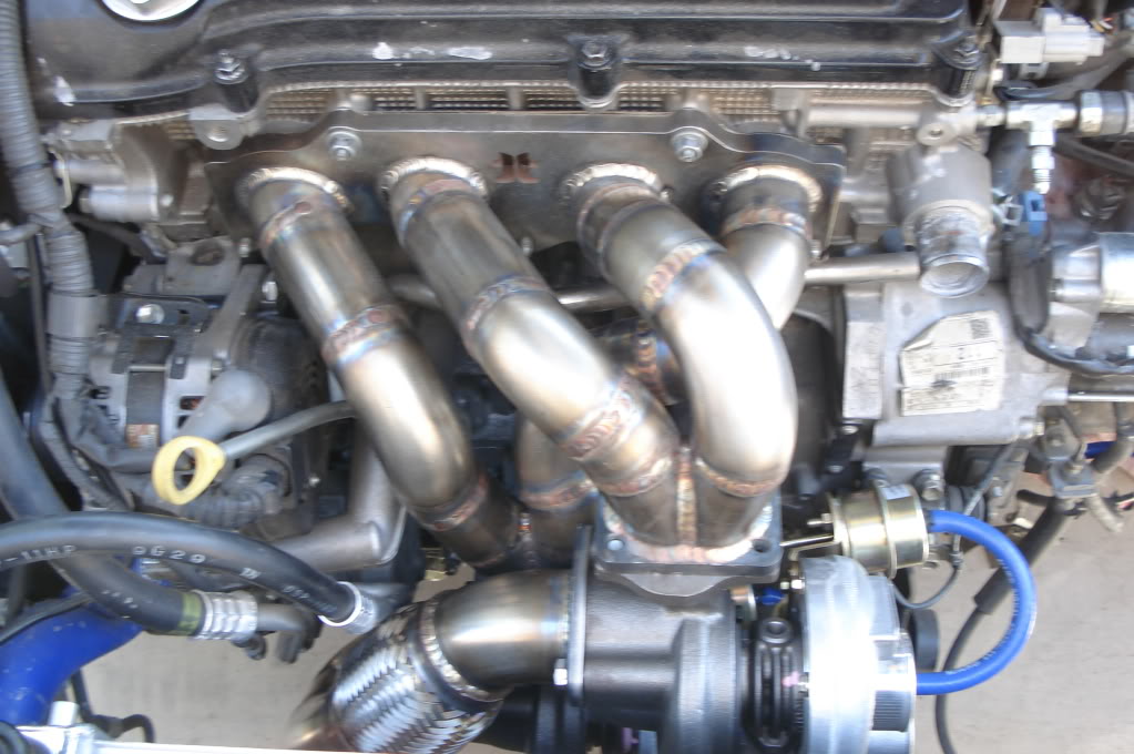

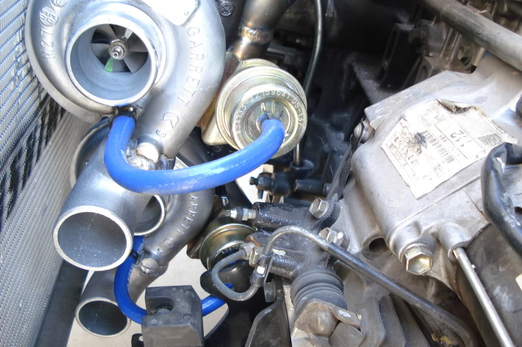

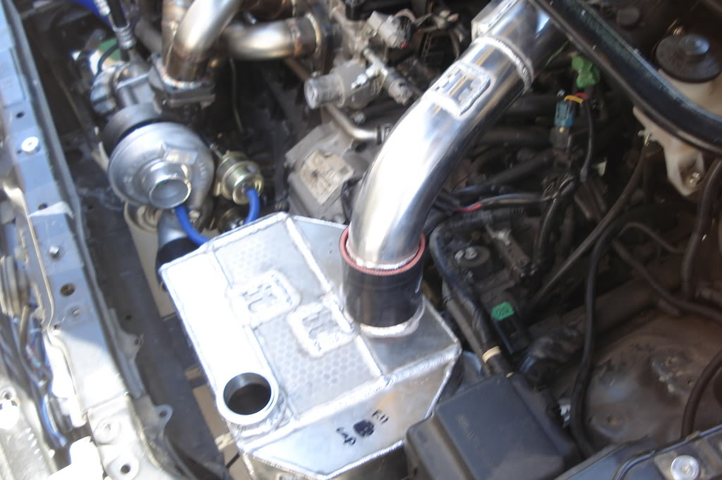

UPDATES:
Mock up picts on the car:

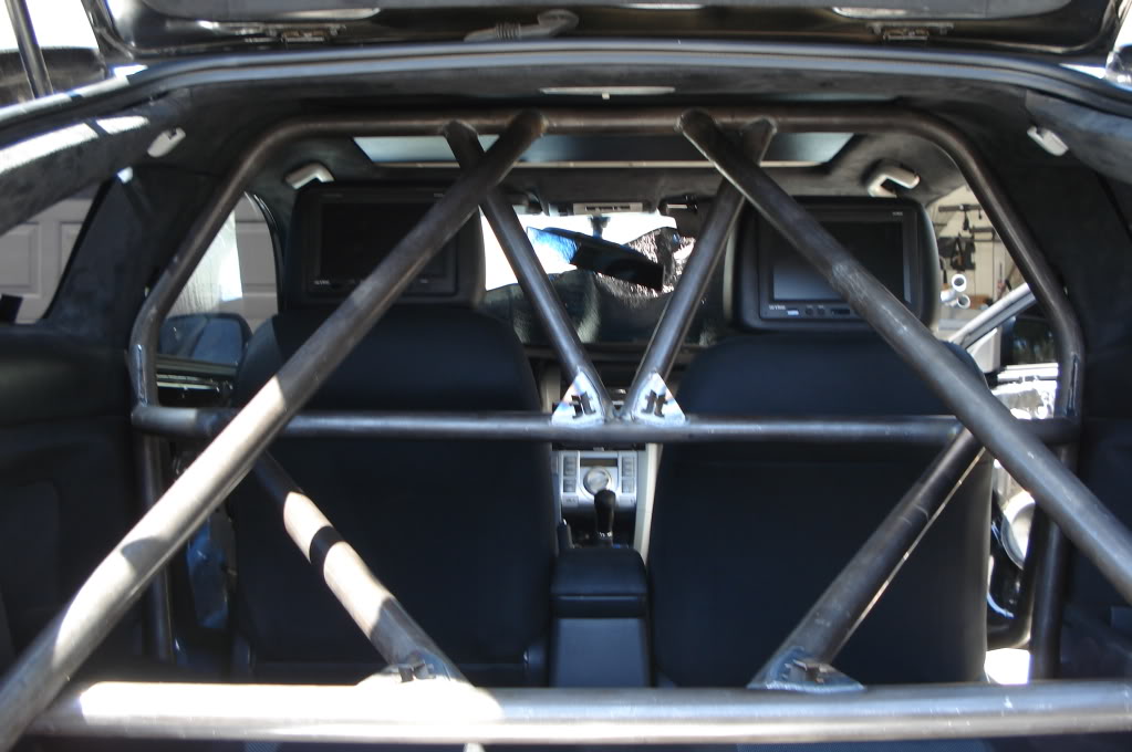

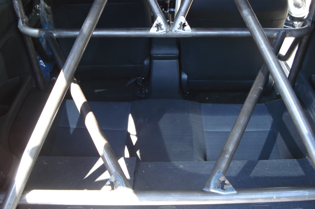

Now for some teaser picts of what we did to the inside
8 pt. Chromoly. She's built to spec in the rear. The front needs to be added on too for to pass any tech. The front has what we like to call "girlfriend bars"
Enjoy!
Regards-
Todd
