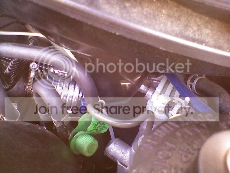

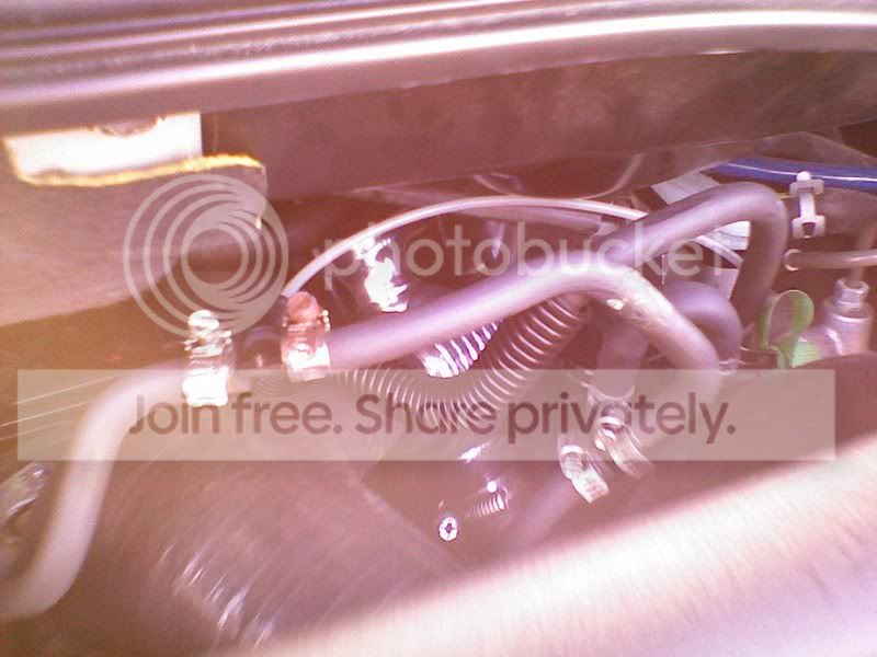

Here are some pics of mine as you can see it gets pretty tight in there.

Got it in the mail on Sat, installed it that morning.
The unit itself is **** for sure, a very sexy piece of quality CNC'ed goodness. So perfectly crafted, it's almost a shame to hide it so far back in the bay.
Install was straight forward. It's not much bigger than Forge's 007 so it doesn't come in contact with anything (brackets, hoses...) Adjustment was a bit of a pita since it's so far back and the DC bar leaves barely enough room to get your hand between the pipes. Once its set right tho, its perfect. Definitely holds boost better than the oem Bosch piece and the sound it great! I definitely have more of that jet fighter sound when cruising and the atmospheric venting with the ~90/10 split is a nice db level, not to loud but just loud enough people can hear it in the car next to you or from the sidewalk.
On to the pics... (details, close ups, in hand for size comparison and installed)
