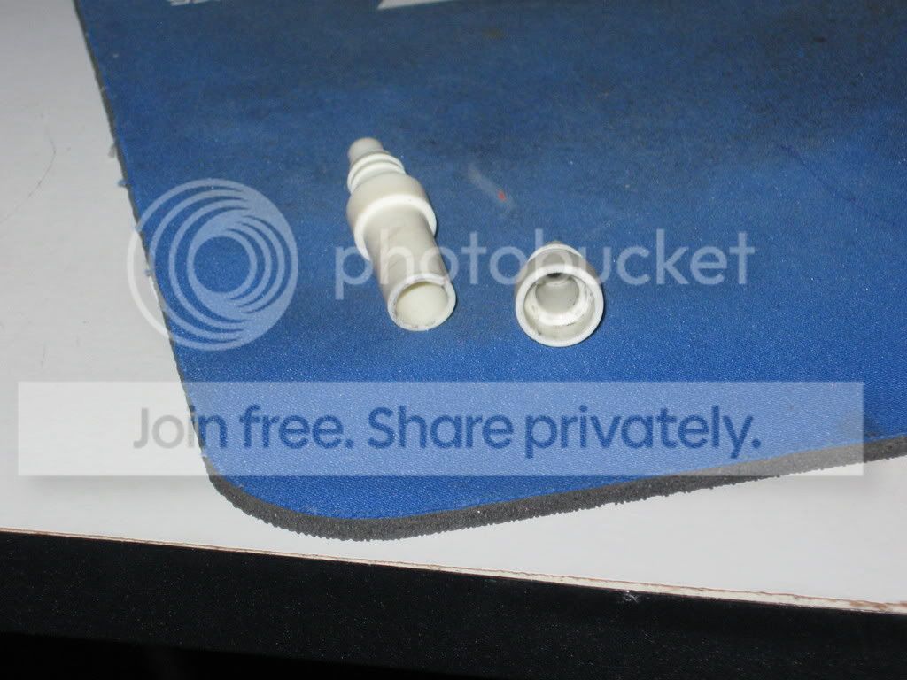

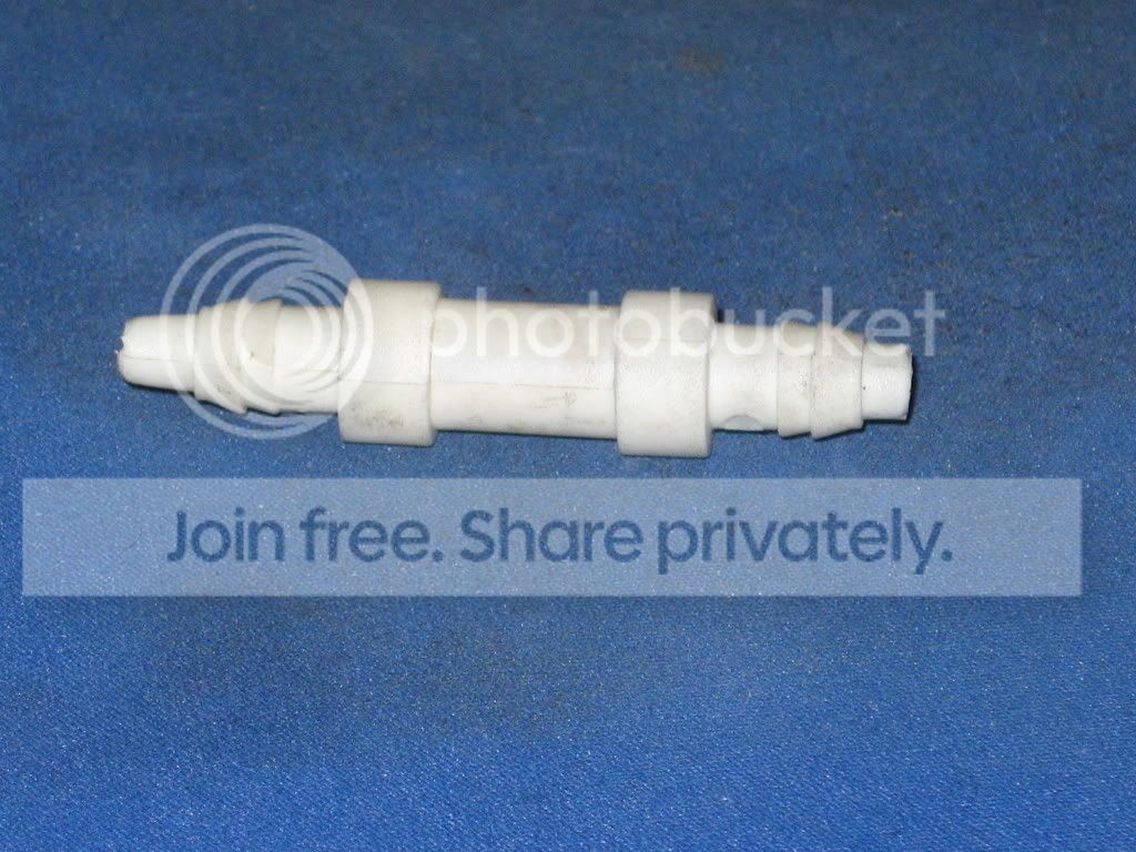

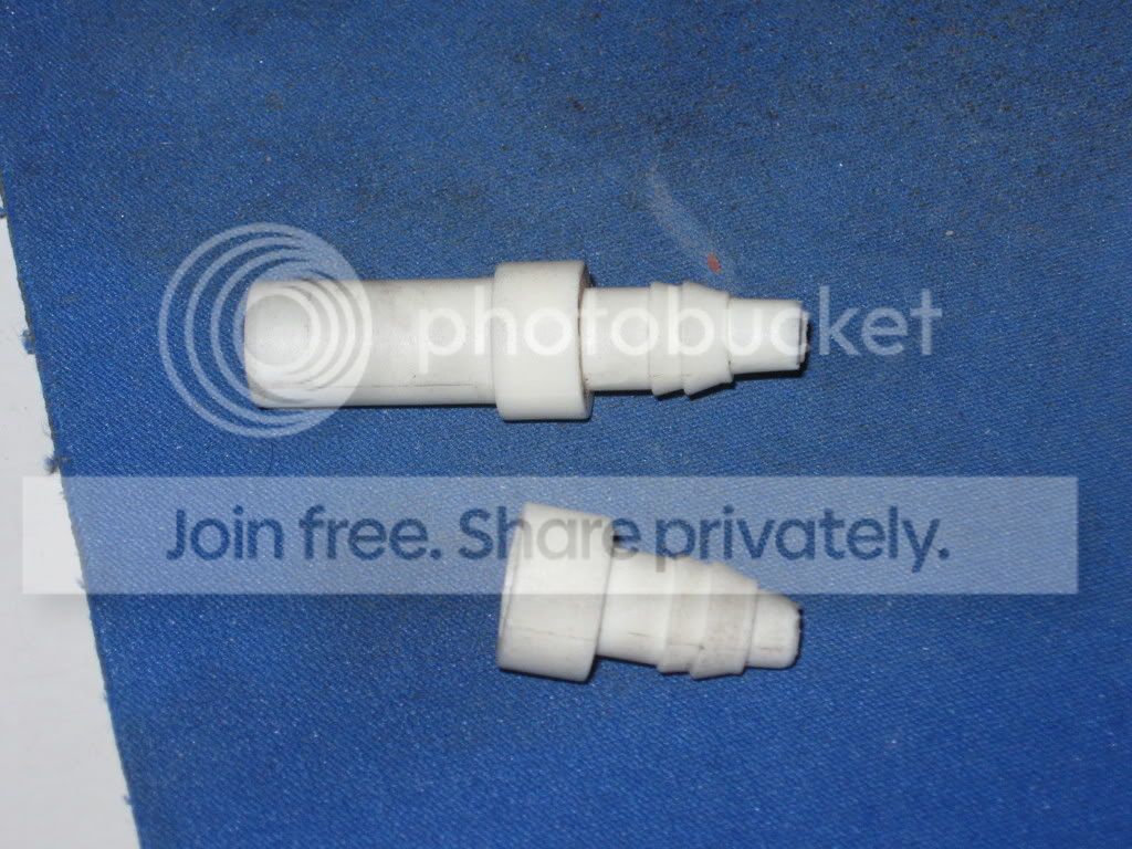

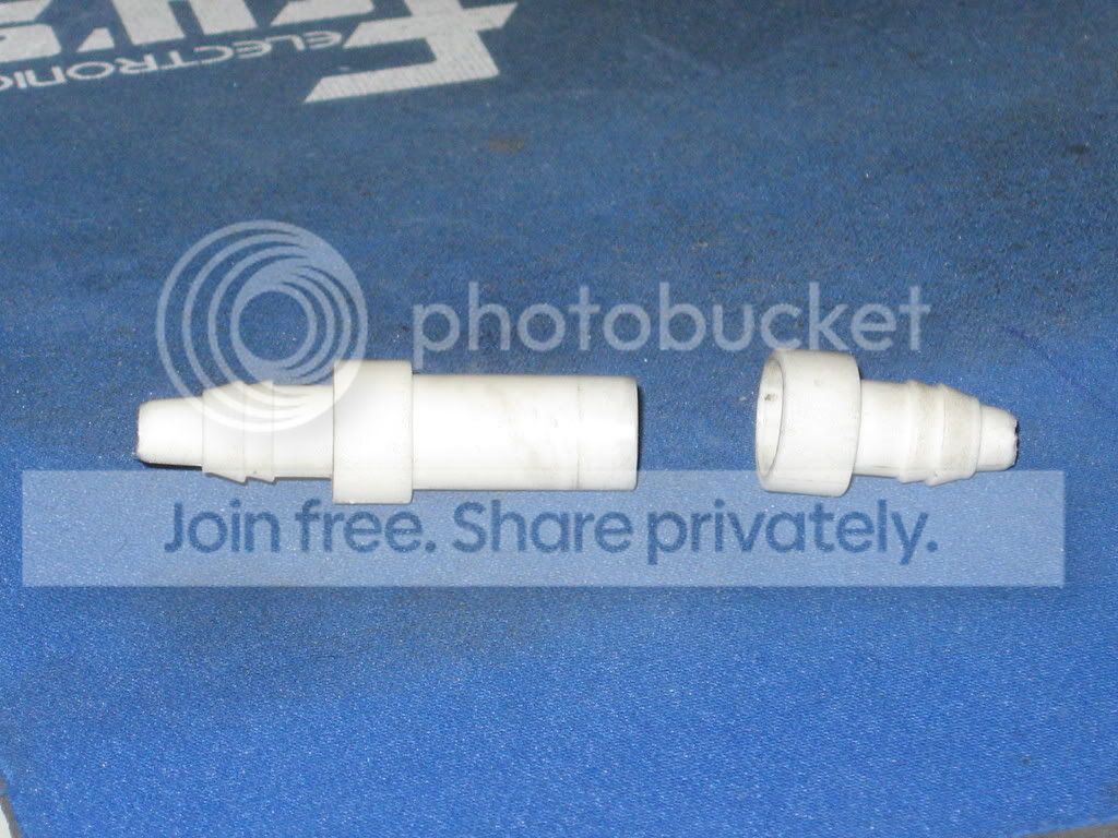

I just got back from the track after having a little diffaculty in the middle of my second run of the night....i got in second gear and suddenly i couldnt boost and the car stuttered real bad, afr's went effing haywire and ran hella lean. i hobbled the car back to the pits to find a vac coupling blew apart.
this is what it is supposed to look like
and this is the way i found it
more shots of it
so if you are using this kind of coupler you may want to rethink it and swap em out for something els.
