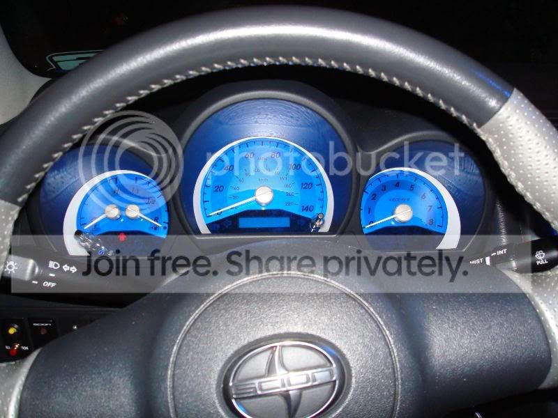

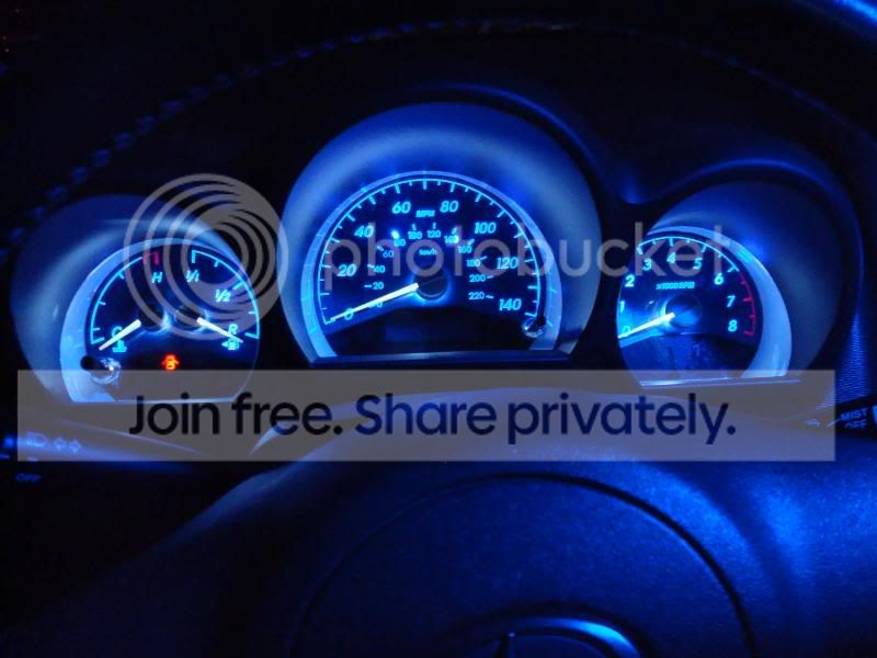

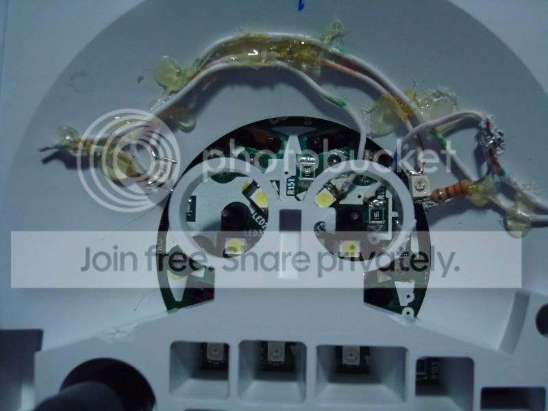

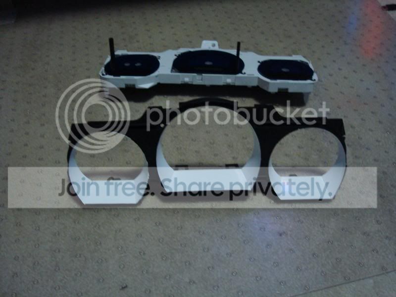

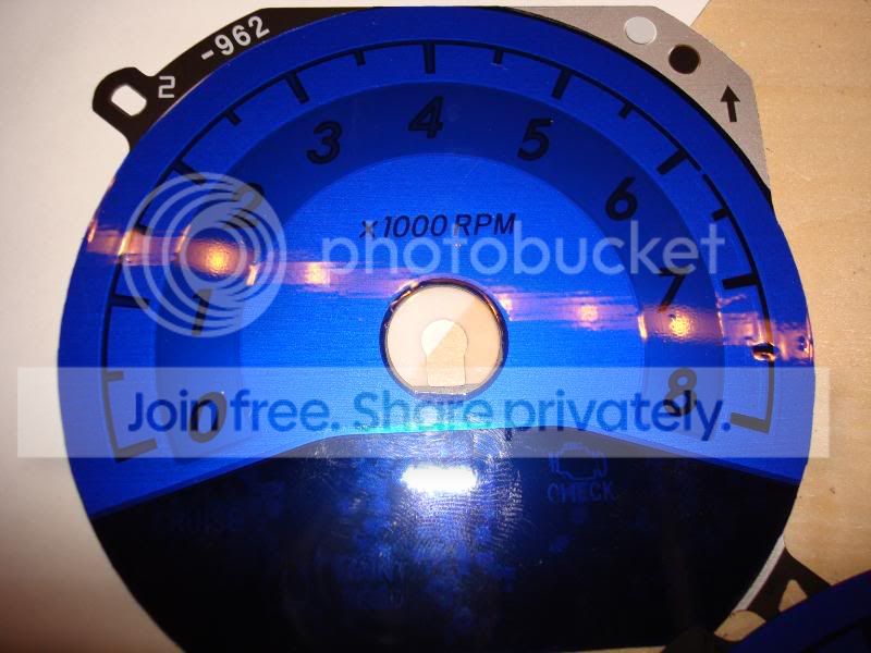

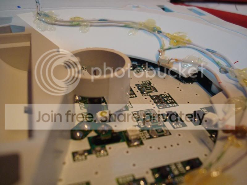

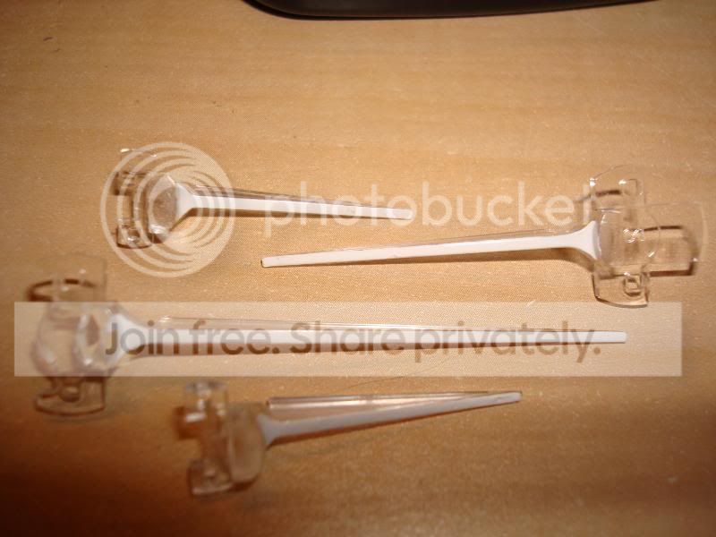

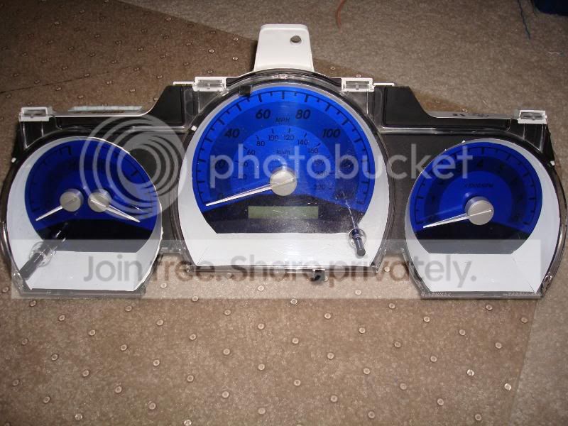

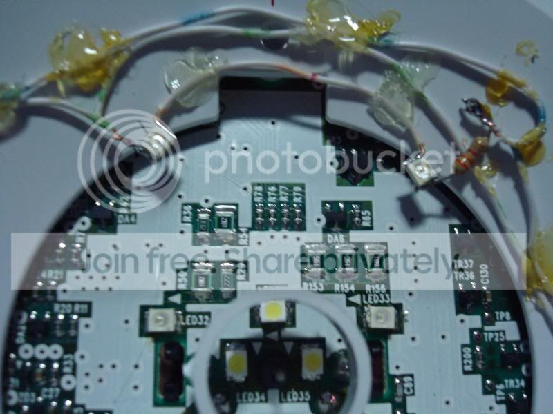

well, i did the white to blue swap.. painted my needles white, added some more led's to the guages, tinted them blue w/ 35% blue window tint and made the inner bezel white.

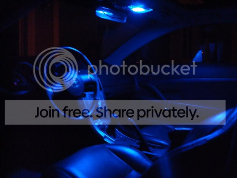

also, made my dome light out of 8 70ma blue superflux led's.. (OMG bright) and the map lights are 2 100ma white superflux's.. very bright.. and i made them strobe.
this was a winter project and just got to posting as i was lazy.
let me know what ya think!

nice!

The white part just doesn't look right...inbetween the cluster trim and gauge face.

i think the vinyl needs to be on the back. looks weird on the front

Looks Good... But not feeling it. IMO

its funny you cover your rear plate but forgot to cover your front plate lol

Unique We usually apply the film we use "translucent vinyl to the the back of the gauges, that looks kind of cool.
Ps... hope that is not hot glue from a glue gun... in the summer the glue will release!

y did u relocate the LED's?
Old May 23, 2008 | 04:56 AM
magyver's Avatar
Posts: 800
it is hot glue, and it'll be ok.. done that before..
they arent relocated, they are in addition.. the tint dims the factory replaced ones. so i make it like the tint isnt there..
it is tinted in the front as i wanted them blue when not lit.

i like the blue. but the white doesn't look good. that must have taken alot of time. i don't have patience for that.
the guage face wouldnt be blue if it was on the inside.... and the point was to have a blue faced guage as well as light up blue.... i like blue, so during the day, i have blue guages.. lol
