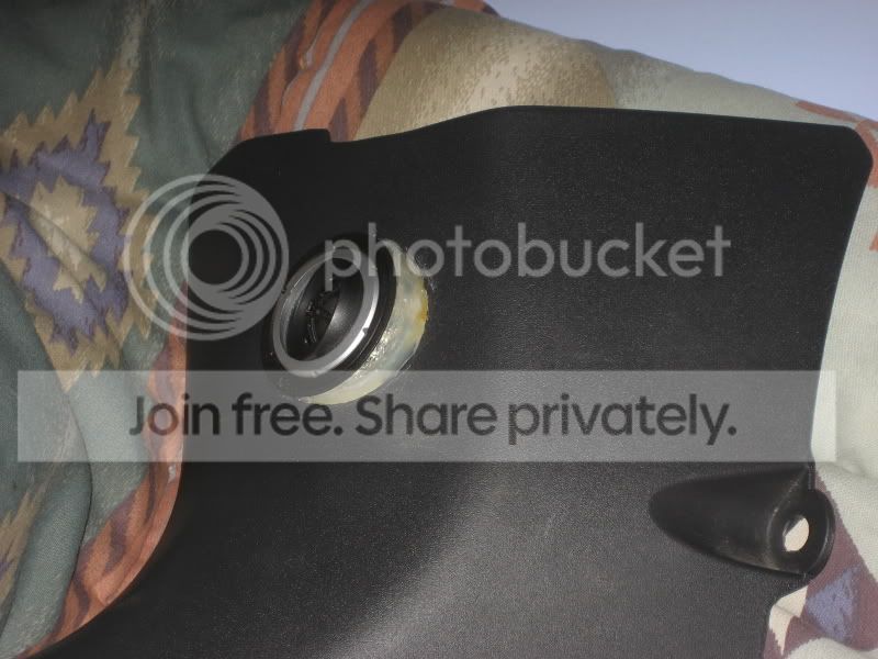

drilling holes in the kicks is easy. the kicks are like $30 each if you decide you need to replace them ever.
the kicks in the tc is a great spot for the tweeters. it keeps them pretty darn close to the mids cause the mids are pretty forward and low in the doors. they (at least in my install) image VERY well! when the volume is at moderate to high levels my stage height it VERY high and has pretty good depth as well.. most of the time when the vocals are centered in the recording itself, my vocals sound like they are coming from about a foot in front (in front meaning like right outside the windshield) of my rear view mirror.
if you put them high in the kicks they won't be blocked by your legs or most passengers legs either. at least if your not a giant. i know my legs and most of my passengers legs don't block the tweeters at all. also if the tweeters you have can swivel, with a bit of work you can get the left side on axis, the right side is cake.
a few quick pics of the rsd tweets in the kicks...
a pic of how i made ghetto pods for the left tweeter to point it on axis..
and a pic from a distance..
soooo... like i said, they work well down there in the tc, especially on axis, its easy to mount them there, and they don't look bad down there either.
