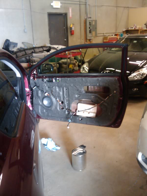

This is the first layer. Then i put that same liquid Edead on the very inside, on the bare metal. Then also i bought the normal Edead, not the liquid and put it everywhere, where you see a hole. In doing so, i had to cut some of the foam on the inside of the Panel.

did you mount the crossover,that might be the rattle

i did, i know thats not the rattle tho. WHere did you mount yours, because i really dont like the way i did mine.
