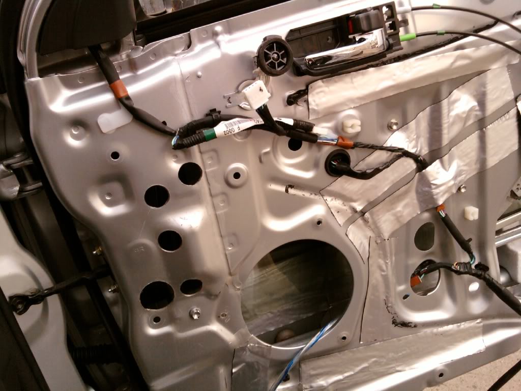

i drilled them out too. then bought some big screws, washers, and nuts to mount the bracket.
Old Nov 22, 2010 | 06:40 PM
explicitiscut's Avatar
Joined: Nov 2010
Posts: 5
thats beautiful
good pics man, thanks
