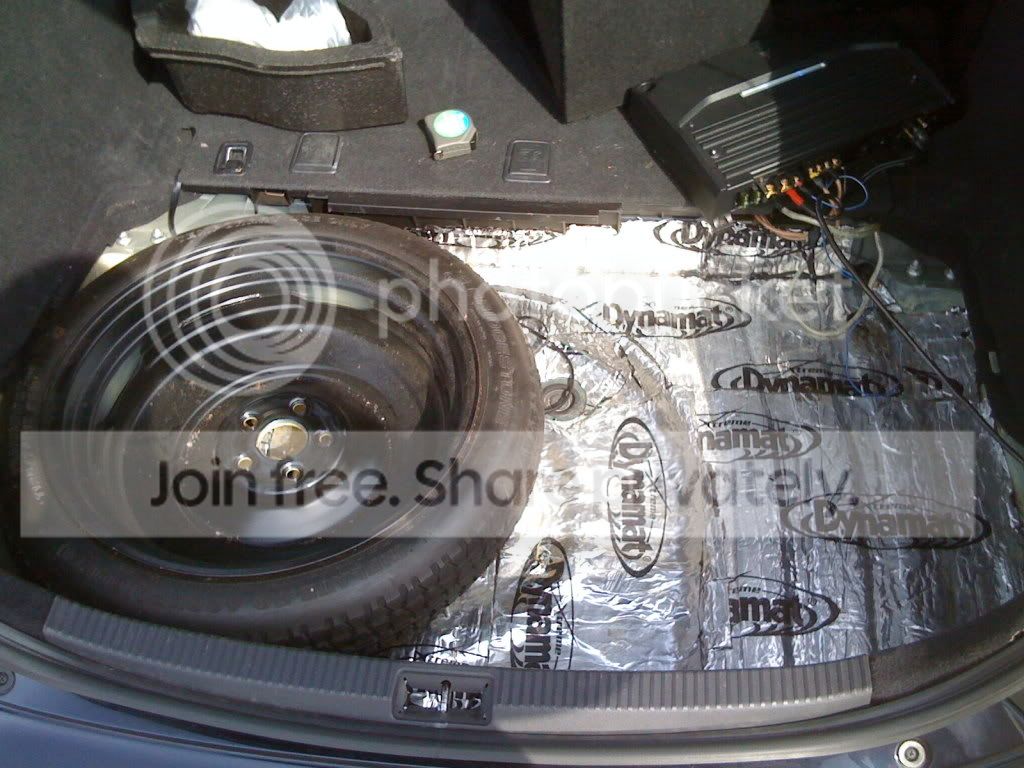

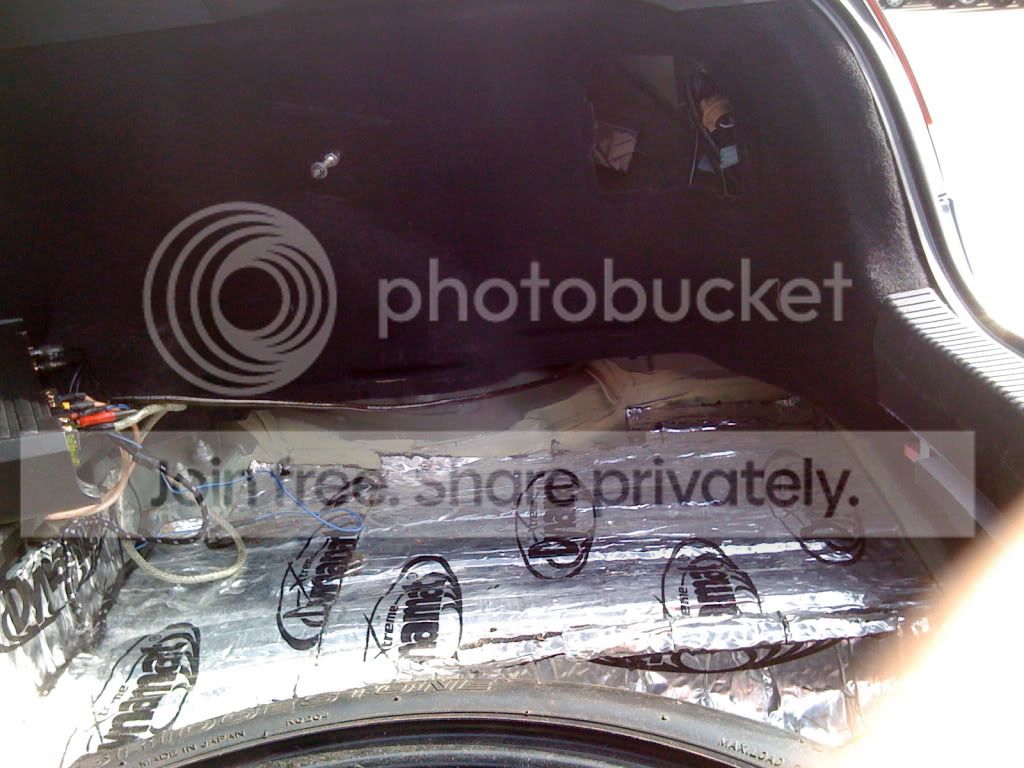

I was going to put it in this empty area of my trunk:
If I filled that area with a massive box, it would be a total of 2.99 cuft, which is wayyyyy too big.
So I am going to have a box made that is about 1.81 cuft, dimensions 20" long, 14" wide, 15" high. I could go a little bigger, such as 20" long, 15" wide, and 16" deep which would give me a total of 2.1, without the displacement of the subwoofer.
I would get it tuned @ 32hz, with 14sqin of port area. Covered in black carpet, sub and port on top side facing up toward back window, and a plexiglass window on the side facing in, so you can see the beautiful structure of the Fi Q subwoofer
How does that sound? Will it make the Q gorgeous?

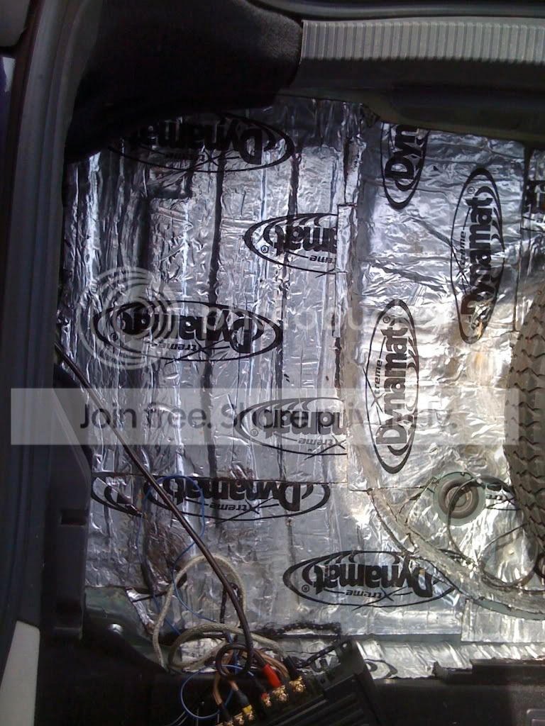

oh and i also forgot to mention that I am going to build a mount for the amp inside the spare, and build an area to hold the spare into, since it will not fit in its normal spot, I am moving the spare over as shown in the pictures.

Fishercustoms is the S*** as far as quality enclosures go. If I had to get one built, it would be from them!
Go as big as possible on the box, even if it have to be 2.5cuft.
