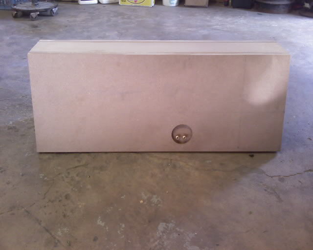

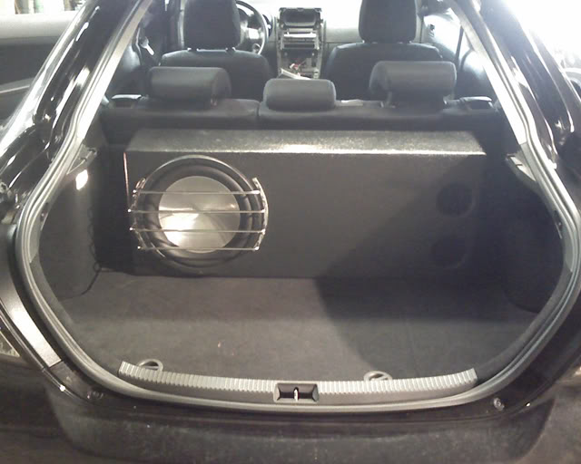

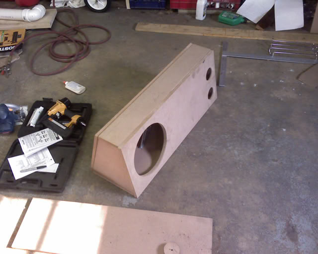

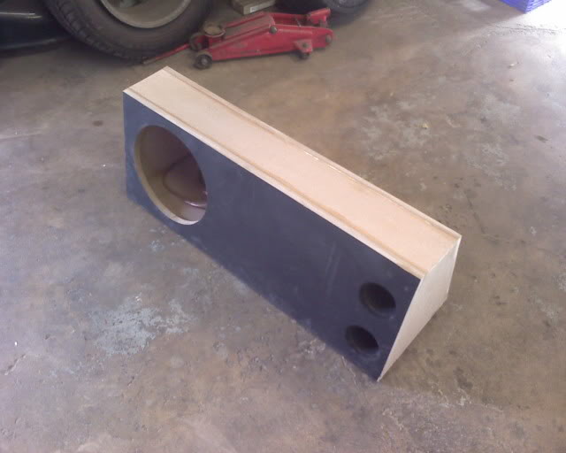

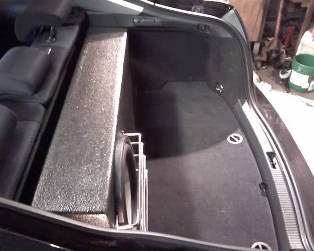

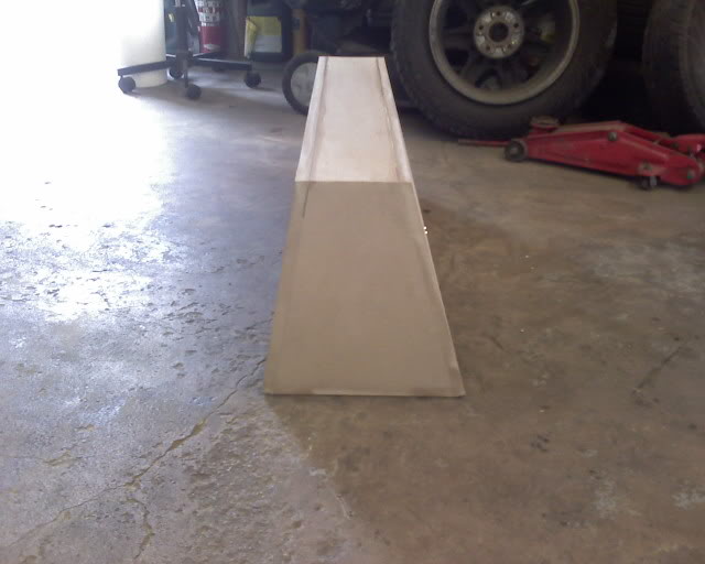

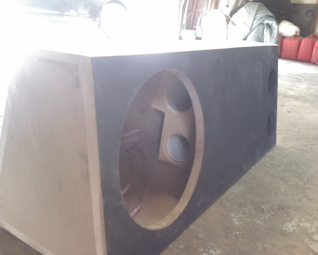

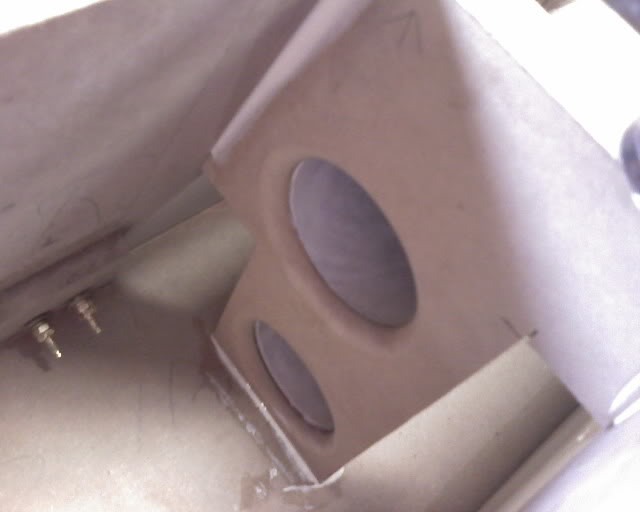

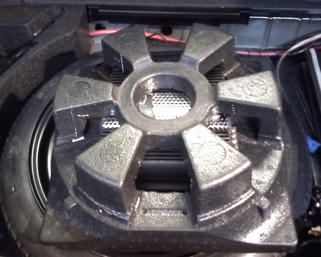

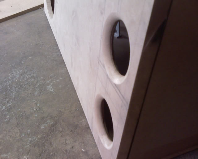

I've had this in my car for a while, but never got around to posting it here. When tc sounds was still making subwoofers for eclipse I had a talk with the engineers and found out that even though eclipse didn't recommend it, the eclipse sub sounds very good in a ported enclosure of the right size and tuned to the right frequency. Anyway i set out to build an enclosure that wouldn't take up all my trunk space and still produce enough bass to keep me happy. The end result sounds great! The sub plays just as tight as it did in a sealed enclosure, while being way louder. My friend who has a 13w7 on jl 1000.1 was impressed with the output, and it is so much tighter than his jl. I am running the sub off of an arc audio 1500dr @ 1000w rms.

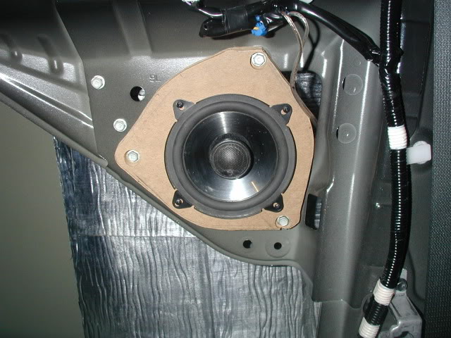

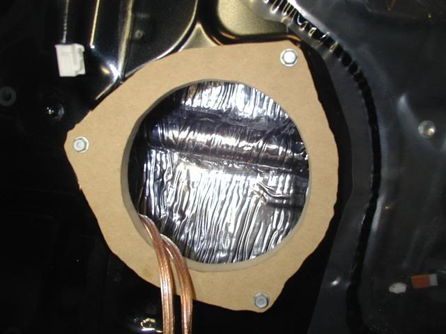

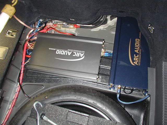

Some more pics of the system, image dynamics cx64 components up front, RF fanatic q 5.25 in the rear. Arc 4150 180w x 2 for the front, kicker 30w x 2 for the rear, pioneer deh-p880prs hu.
