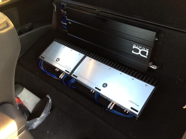

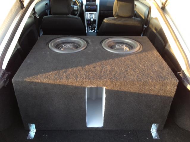

Old May 1, 2012 | 09:17 PM
NavyRigger's Avatar
Joined: Jan 2011
Posts: 15
idea of what I'm working with
Attached Thumbnails I can NOT get this car loud!!!-amps.jpg   I can NOT get this car loud!!!-subs-box.jpg

Im on all the bigger audio forums but most people always say subs up port back in a hatch. The way our trunks are layed out I dont think we are the norm. the way it slants down in the back is the difference

hmm yea usually hatches are that way. i know i saw much difference facing up than i did straight back. (sealed box) i'd almost think port facing the front or the hatch (i've seen one tc that had a L7 15 that was built facing up and the port facing up but not sure how it was or was ever metered)

What is that port tuned for? 45-50hz for burp and I'm sure you'll gain(depending on the resonate frequency of your car). If this is a daily box maybe build a removable port insert, if you're serious that is. I never tried making my tc loud but my integra sub up port up worked best. Good luck.

Tuned at 35 on this box. I'm not going to give up daily listening to get it loud. Thats why i got this kind of power so I wouldnt have to. We built a teg a while back, it was subs up and worked good also.

Try subs back port back. I had 2 12s in my car facing back tuned to 31hz off 4cf airspace. I also had an 18 facing up and facing back. It always seemed louder facing backwards with the port in my car. maybe that helps you, ive been out of the audio game for a while now lol
