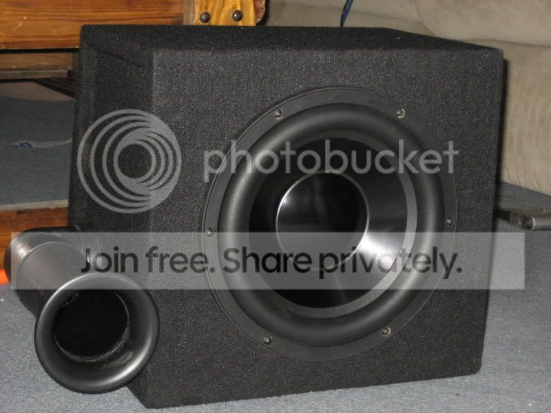

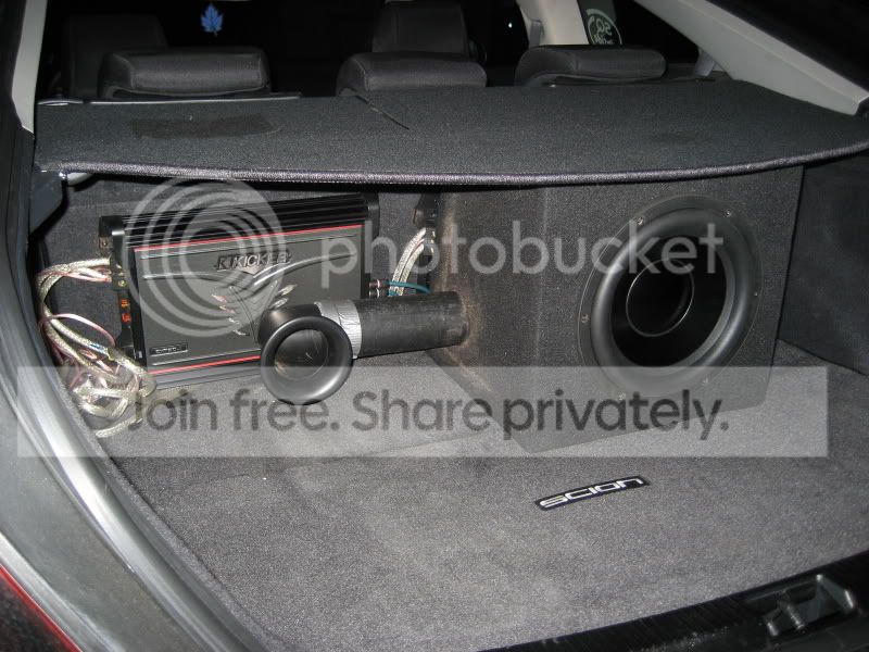

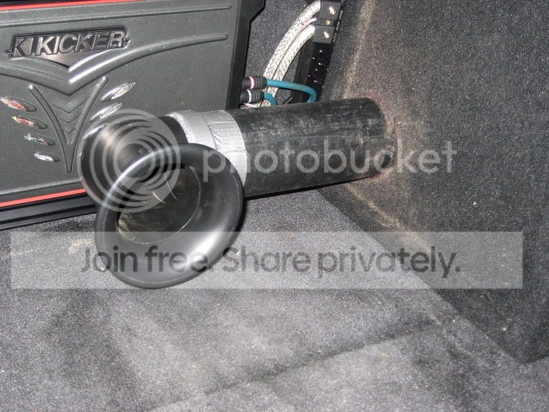

well as some of you guys know i wanted to try a new sub. i went with the Dayton Reference HO ten. it's in a .85 cubic foot gross about .72-.78 net enclosure tuned to around 28-30 hz. i used the 3" port tubing from parts express with their flares and right angles. the box was a sealed box that i took and cut a hole in. half of the 25" long port is inside the box and the rest is obvious... lol.
this setup is getting around 400 watts rms from my kicker ZX750.1. i went from the Treo SSi to this. it's getting half the power but since the sensitivity is higher it sounds almost as loud. i wasn't looking for pure output. i was more concerned with SQ and this setup has just the sound i was looking for. it's got a much tighter harder hitting sound. it doesn't have the huge hump in the bottom end like the Treo had. it has a more flat sound for sure. it's not "beating your chest in" loud but it does hit very very nicely on double bass and the bass guitar sounds way more accurate and clear.

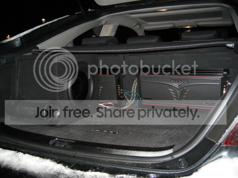

i know i need to clean up my wiring and i'm going to do the port a lil differently but this is it for the most part. it was cold and i didn't feel like sitting outside trying to route my wires neater. the next warmer day i have it will get fixed. it was about 20 degrees and i was already crazy enough for taking my old 60 pound box out and remounting amps when it's this cold.
anyway on with the pics....

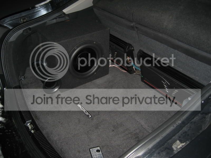

this is what it looked like before...
it was much neater but this will look just as neat when i get time to clean it all up.

ha
man i dunno how u can't laugh at it
Old Dec 7, 2007 | 04:38 AM
Tcguy85's Avatar
Posts: 2,434
From: Hyde Park, NY
it does look a little ghetto at the moment but good luck trying to get a 3" wide by 25" long port inside a box this small. it sounds good which is what matters most. and once i get more time i will make it look nice.
Old Dec 7, 2007 | 04:39 AM
nebster's Avatar
Posts: 8,961
From: Team SOLO
use at least some pvc sealant please and get rid of the duct tape. what i would do is make a trim panel with cutouts for the sub and port
Old Dec 7, 2007 | 04:42 AM
Tcguy85's Avatar
Posts: 2,434
From: Hyde Park, NY
it will look better soon.... don't you worry. i just threw it in the car real quick. like i said it's under 20 degrees here right now.

i will make it look better though as time goes on. i will replace the duct tape with glue and the wiring and amp mounting will be cleaned up. it was thrown together real quick and sorta temporary. it will look clean again shortly. i will post new pics up after i get it all cleaned up.

i must say that port is pretty custom if reminds me of one of those snorkel intakes on a hummer. but i like the setup. good job

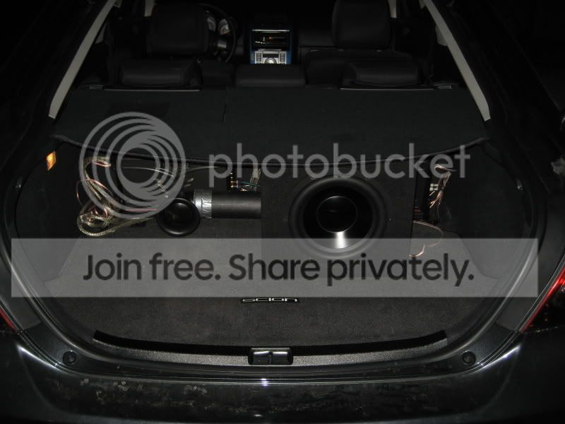

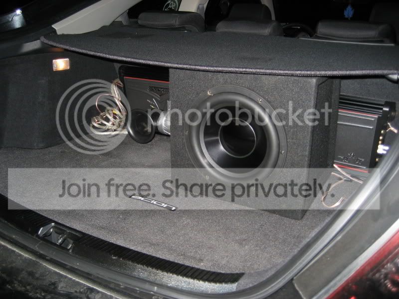

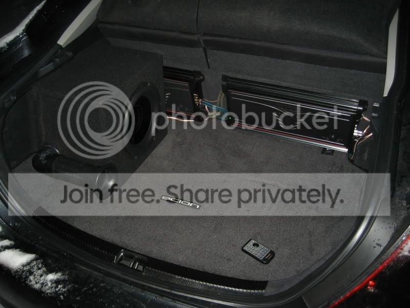

ok i shaped the port a lil differently and also relocated the box in the trunk. it sounds the best when firing to the side like so. it gained a lil output and kicks harder positioned like this. it looks a lil better this way. i'm still gonna have to wait on a section of power wire so i can reroute the wires. but this is pretty much how it is going to look.
this is what it looks like inside the box
Old Dec 8, 2007 | 05:20 AM
Dakine's Avatar
Concept in Motion Crew
Posts: 2,758
little better.
