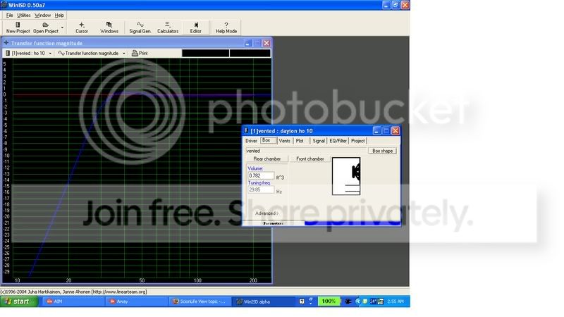

it's tuned low...... 30HZ. with this size port and box and tuning it has very flat response. the F3(-3db) point is down at 28hz. it sounds ammmaaaaazzzing!

and what formula did you use for the round port to get the tuning?

nah, i didn't just cut a hole in a sealed box and call it a day. it was a sealed box that i cut a hole into but i spent time figuring out tuning and all that good stuff. it seriously sounds amazing, honestly. i am truly shocked to get such a good sound out of such a small box. i'm done with SPL and i'm heading towards SQ now. not that i ever had a REALLY loud system but if it doesn't sound perfect i'm not happy.
oh and i used a program called WINISD to figure out box size and tuning.
Did you make the port the exact length WinISD specified? If so, your port is too short. That software and others like it presumes the port won't be close to the box walls. The length they specify only works if the tube is located at least the same distance as it's diameter from every surface. Your hole in the corner and routing of the tube close to the inside walls will require a longer port to acheive the same tuning frequency as when the port is optimally implemented. Even if you already knew this, I hope others take note, because those unaware might follow your example and get less than the expected result.
Nothing wrong with some or all of a port being outside the box, and it gives you a lot of opportunity to experiment with directional loading and aesthetics.
As for SQ, that sub will sound even better in a smaller sealed box, and still produce flat bottom-octave bass due to the car's transfer function. If the output isn't enough in a sealed box (better trade-off than the increased group-delay due to porting, imo), the RSS315HO-4 (12") would get the job done, as it's -3dB point is <30Hz anechoically in just a 0.65' enclosure, which would be <20Hz in-car. You can check it out HERE if you haven't already seen this implementation.

if you're looking for only sq you should tune down to like 17-25 that will give you an amazingly flat response (or should)
i didn't know this.... have anything proving it? slot ports are against a wall too. i have never heard anybody mention this.
